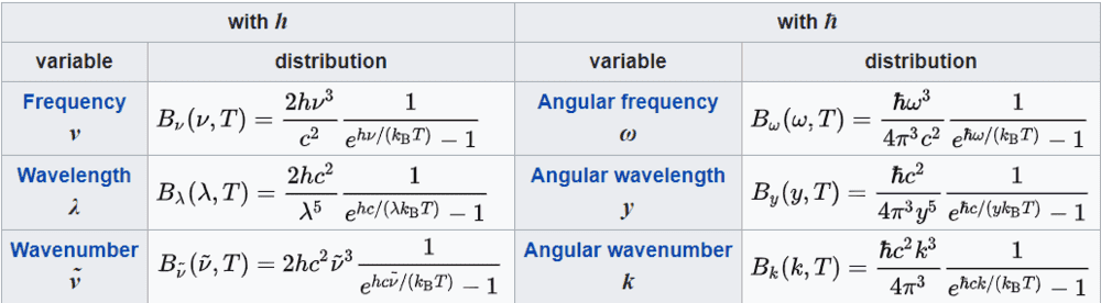

However, I also see this lovely table
241120
yet again, not sure if any of these things are related to what I am supposed to be looking for.
