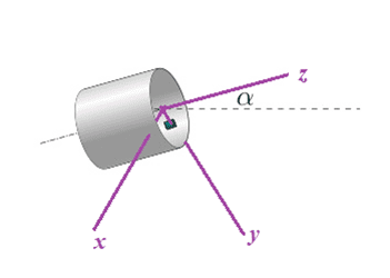

OK, I'm not sure I follow your description of the y axis. Suppose you pick the axes as shown below for ##\alpha \neq 0##. The z axis is the axis of the cylinder and the yz plane is vertical. The x-axis is then horizontal.
How would the components of ##\vec{g}## be expressed in this coordinate system?
When the block is at the angle ##\theta## shown, what would be a unit vector in the centripetal direction?
Use these vectors to find the component of ##\vec{g}## that is normal to the surface when the block is in this position.

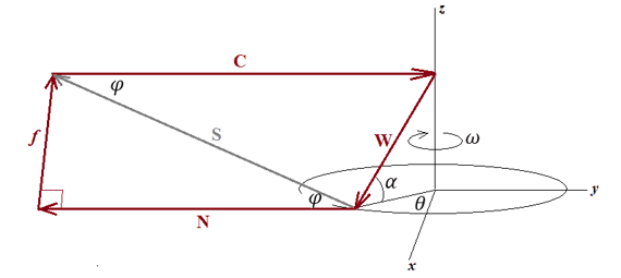

I'm not sure if my diagram is similar to yours. I chose an x-y-z coordinate system rotating with the cylinder as shown:
In the rotating frame of the cylinder, the block and the x-y-z axes remain fixed with the y-axis passing through the block.
The forces acting on the block are shown added together in the force diagram below where I reoriented the diagram so that the x-y plane is oriented horizontally in the figure.
The normal force N and the centrifugal force C are always parallel to the y-axis. In this orientation of the figure, the axis of the cylinder (z-axis) is vertical. In this frame of reference, the x, y, and z axes remain fixed while the vector representing the weight W rotates around the z-axis with angular speed ##\omega##. Thus, W sweeps out a cone with the tip of the W vector tracing a circle. W maintains a constant angle ##\alpha## to the x-y plane, where ##\alpha## is the amount of "tipping up" of the cylinder in the first diagram above. The friction force f varies in time so that these four vectors (f, C, W, and N) always add to zero. (The block is in static equilibrium in this frame.)
The time-dependent vector S is defined as the sum of the forces N and f.
##\theta## gives the instantaneous angle that the tip of W has rotated from the x-axis.
##\varphi## is the angle shown in the triangle formed by f, N, and S. ##\varphi## varies with time.
Is this similar to the diagram that you had in mind?
Note that the block is on the verge of slipping if ##\tan \varphi = \mu##. For the block to not slip, we must have ##\varphi \leq \arctan \mu## for all positions of W as W sweeps out its cone. Using this idea along with the geometry of the figure, you can deduce the minimum value of ##\omega## for which the block will not slip.

Your vector R is the same as my vector S. (I didn't want to use R, since this symbol is also used for the radius of the cylinder.) At any instant of time, all five vectors N, C, W, f , and S lie in one plane. The orientation of this plane changes with time. For example, when ##\theta = \pi/2## or ##3 \pi/2## the plane is vertical in the figure of my previous post.
It all seems complicated, but the only thing that we are really interested in is the maximum value of angle ##\varphi##. If ## \tan \varphi## exceeds ##\mu##, the block will slip.
The magnitudes of C and W remain constant in time. With that in mind, if you wanted to maximize ##\varphi## in the triangle CWS, how would you want W and S to be oriented relative to each other?
