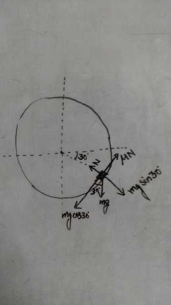

Picturing a cross section of the hollow cylinder rotating with an angular velocity of 2π radians/sec with forces marked;
Hand-drawn free-body diagram of a block at rest on the inner wall of a circle representing a cross section of a hollow cylinder, showing the normal force N, friction force μN, weight mg, and components mg sin30° and mg cos30° at a 30° angle below the horizontal through the center.
Equating forces as the block can be assumed to be in rest (constant slipping);
(There would be no centripetal force because the block isn't moving with the cylinder, or isn't in a circular motion)
Mgcos(30) = μ[Mgsin(30)]
=> μ= √3
Which contradicts the statement made by the question that coefficient of friction is 0.6.
Also, this isn't giving any information about the radius as the radius doesn't even come in the equations.

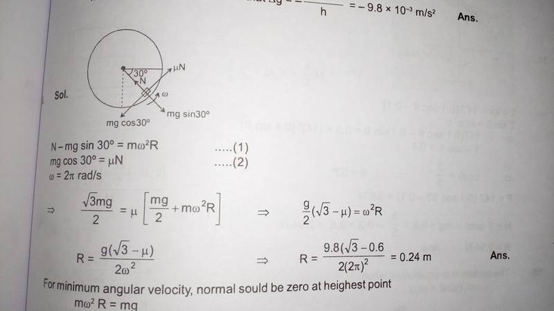

However, according to the book, the solution is
Handwritten free-body diagram of a block on the inside of a circular hollow cylinder at 30 degrees below the horizontal, with forces N, μN, mg cos 30°, and mg sin 30° labeled, followed by equations (1) and (2) and a worked solution for R.
The solution considers the ω of the block (equation1) to be the ω of the cylinder, when in actuality, the ω of the block is zero (it's at rest), and 5hus there shouldn't be any centrifugal forces acting on it.Please guide as to where I am wrong. I am sure 5to be missing some concept, because the question is correct. Thank you very much.
I think the problem wants you to assume that the block is placed at the bottom of the rotating cylinder such that the block is initially moving with the wall of the cylinder. So, initially the block is not slipping on the wall. The block moves with the wall without any slipping until it reaches the 30 degree position at which point slippage begins.
The question says
SciencyBoi said:
at which it begins to slide
That is, it was rotating with the cylinder until the given angle was reached. The transition to sliding is determined by the balance of forces just before it started sliding.
haruspex said:
The question says
I have now understood it. It was a language problem apparently. Thank you very much.
Thank you very much, I seem to have understood it now.
