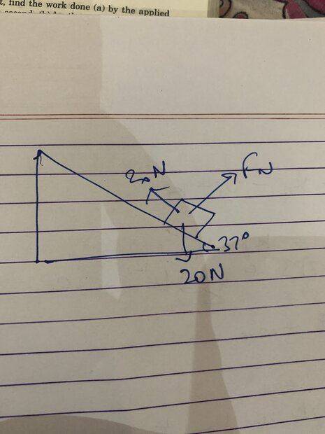

A block of mass 2.0 kg kept at rest on an inclined plane of inclination 37° is pulled up the plane by applying a constant force of 20 N parallel to the incline. The force acts for one second. (a) Show that the work done by the applied force does not exceed 40 J. (b) Find the work done by the force of gravity in that one second if the work done by the applied force is 40 J. (c) Find the kinetic energy of the block at the instant the force ceases
to act. Take g = 10 m/s
##v=u+at##
##W=F.d##
##v^2=u^2+2as##
a) $$v=u+at$$
$$v=0+(F/m)t$$
$$v=-10$$
Now $$v^2=0+2as$$
$$s=-5$$
$$W=F.d=(-20)(-5)=100J>40$$
b) $$W=-mgh$$
$$W=-20(3)$$
$$W=-60$$

In my humble opinion, I'd suggest checking your setup for acceleration. What other forces are there acting upon the "x" (parallel to the plane) direction?

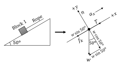

The F that you use in your equation should be the net force, or addition of all the forces that are parallel to the incline.
Forces acting in opposite direction to the given 20 N do not allow the block to reach the values of velocity and distance that you have calculated.

Yes! Parallel force!
That is only the applied 20N force
Maybe F_N is slowing down the block but that is not parallel to the incline plane.
What is the reason for the incline to be present in this problem?
Why it is harder to ride a bicycle uphill?
Because of the Weight of the bicycle
Exactly!
Where is the weight of the block being considered in your calculations?
Lnewqban said:
Exactly!
But how can we find net force if weight is downward and applied force is parallel to the incline?
The weight of a drop of water is also downward, and still, it makes a river flow.

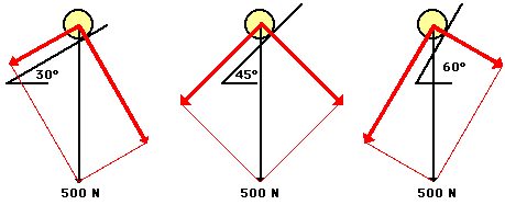

Would it matter if the incline were 10 degree instead of 37 degrees? How about if it were 75 degrees?

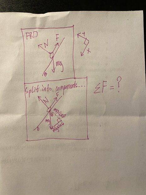

I think what Lnewqban is getting at is that we should split the force due to gravity into "x" (direction parallel to incline) and "y" (direction perpendicular to incline). I noticed in some of your earlier threads that you err in the pattern of thinking that mg is always perpendicular to motion (which is a reasonable error, because we're usually initially taught in horizontal planes).
We want to split mg into these components because I think we want to always consider forces in the direction of motion. After all, F = ma, and it's much easier to solve for acceleration if F is in the same direction!
EDIT: Lnewqban beat me to the diagram :p
