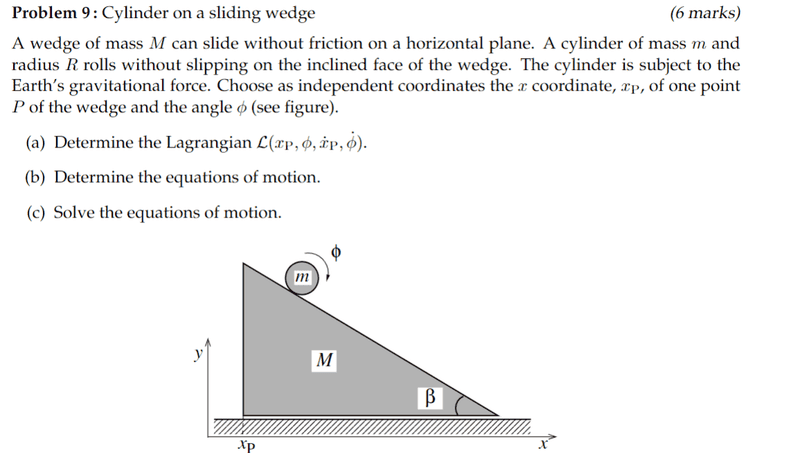

Classic Incline problem with cylinder
13 replies · 2K views · last reply
member 731016
Please seee below
Please seee below
FOr this,
Diagram of a cylinder of mass m and radius R rolling on the inclined face of a wedge of mass M, with angle phi marked at the cylinder and angle beta at the base, on a horizontal surface. The point P is labelled xP on the x-axis.
Use alternate coordinate system
Hand-drawn red marks: a long arrow pointing right, a second arrow angled down and to the right, and a small hand-drawn cross or X shape with a horizontal line above it.

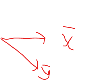

With ##ȳ##-axis parallel to incline and ##x̄##-axis parallel to the x-axis. Kinetic energy using this alternate coordinate system is ##T = \frac{1}{2}M\dot x_p^2 + \frac{1}{2}mR^2\dot \phi^2 + \frac{1}{2}m(\dot x̄^2 + \dot ȳ^2 + 2\dot x̄ \dot ȳ \cos\beta)## and potential energy is ##V = -mgȳ\sin \beta##. Note how potential energy of block was not included as we don’t know where the height of the COM is, however, it is a constant, so we can just all the high c, and it will add a ##+C## to the lagrangian
Now transform to original x-y coordinate system using transformations ##ȳ = -\frac{y}{sin \beta}## and ##x̄ = x + y\cot \beta## from decomposing ##ȳ## along the x and y axes. I think that ##\hat ȳ = \hat i - \hat j##. Then one would substitute the these transformations into the kinetic energy and potential energy expressions, however, how does one the ##x## and ##y## in these transformations in terms of ##x_p## and ##\phi##.
Thanks!
The cylinfer has velocity of
x direction : ##R\dot{\phi} \cos \beta + \dot{x}_P##
y direction : -##R\dot{\phi} \sin \beta ##
and potential energy of ##-mgR\phi \sin \beta## which is 0 for ##\phi##= 0

You still have not said how you define ##\hat i, \hat j##. If those are ##\hat x, \hat y## then I get ##\hat{\bar y}=\cos(\beta)\hat i-\sin(\beta)\hat j##.

Also does someone please know what the GPE of the block is? Is it ok if I just say the heigh of the COM is y = -k, where k is a constant?
For (c), I am trying to solve the equations of motion. In terms of integration constants, I solve the second order ODE coupled system and I have ##\phi = ht + k## and ##x_p = wt + c##. However, does someone please know what is good assumption to make to find Inital conditions?
I was thinking ##\phi(0) = \phi_{qi}##, ##\dot \phi(0) =\dot \phi_{qi}## ##x_p(0) = x_{2e}## ##\dot x_p(0) = \dot x_{2e}##
Thanks!

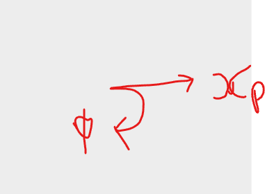

Sorry I am confused what you are saying. Do you please mean that I need ##\phi## and ##x_p## axes?
That is a interesting idea to consider. However, do you please know how one would draw them?
Hand-drawn red scribbles on a grey background: a vertical arrow with a loop near its base, a curved arrow pointing right, and a small looped shape with a line at the right edge.
Not sure what one would call them but is is certainly not orthogonal. Maybe simi-cyclic coordinate system?
Axes are x and y as I wrote x- y- directions of velocity in my post #2.
In xy coordinate, ##P(x_p,0)##. The contact point on the slope ##C(x_C,y_C)## in xy axes coordinate is
[tex]x_C=x_P+R\phi \cos \beta+x_{C0}[/tex]
[tex]y_C=-R\phi \sin \beta+y_{C0}[/tex]
where ##(x_{C0}, y_{C0})## is initial position of C when t=0, ##\phi=0##. Then the center of cylinder ##Q(x_Q,y_Q)## are given as
[tex]x_Q=x_C+ R\sin \beta[/tex]
[tex]y_Q=y_C+R\cos \beta[/tex]
by adding constants. All these things are in works of xy coordinates. You get Lagrangian from these Cartesian expressions. Once you got Lagrangian written by ##x_P## and ##\phi## , forget about Cartesian coordinates and go into analytics of ##x_P## and ##\phi## by Lagrange equation, which is the merit of analytical mechanics.

ChiralSuperfields said:
x vs x_p coordinate. I don't think that x is the same as x_p
You are right…
As I understand your working, (x, y) is the location of the centre of the cylinder in the coordinates as diagrammed.
If ##(\bar x, \bar y)## is the same point in your ##(\hat{\bar x}, \hat{\bar y})## coordinates then ##x\hat x+y\hat y=\bar x\hat{\bar x}+\bar y\hat{\bar y}##.
Also, ##\hat{\bar x}=\hat x##, ##\hat{\bar y}=\hat x\cos(\beta)-\hat y\sin(\beta)##, whence ##x=\bar x+\bar y\cos(\beta)##, ##y=-\bar y\sin(\beta)##.
This choice of coordinates effectively considers the motion of the cylinder as the same motion as the block (##\dot x_P=\dot{\bar x}##) plus a motion down the slope of the block (##\dot{\bar y}=R\dot\phi##).
