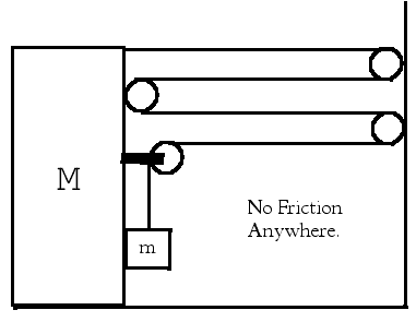

A block of mass M is connected with a particle of mass m by a light in-extensible string as shown in the figure. Assuming all the contacts as smooth, find the acceleration of the block after releasing the system.
F = Mass * Acceleration
Normal Constraint : The acceleration of two particles in contact is same along the line perpendicular to their line of contact.
String Constraint : The length of the string is constant and could be used to find out the acceleration of the corresponding components using differentiation(using geometry).

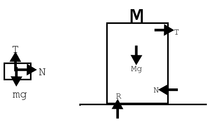

Using the FBD and Translational equations
The particle will have the acceleration both in x and y direction. The block will have the acceleration in x direction due to tension in the string and contact force .
for block M
[tex]\ T\ -\ N\ =\ Ma_x[/tex]
The particle's acceleration in the x direction will be the same as that of the block in the x direction in accordance to the normal constraint.
for particle m
[tex]mg\ -\ T\ =\ ma_y\\<br /> \ N\ =\ ma_x\\<br /> \implies\ T\ =\ (m+M)a_x[/tex]
Using string constraint we get than the particle's acceleration in the y-direction would be 4times the acceleration of the particle in x-direction
[tex]4a_x\ =\ a_y\\<br /> \implies\ mg\ -\ T\ =\ 4ma_x\\<br /> \implies\ mg\ -\ (m+M)a_x\ =\ 4ma_x\\<br /> \implies\ a_x\ =\ \frac{mg}{5m+M}[/tex]
But the answer I get is wrong and the correct answer is [itex]\frac{4mg}{17m+M}[/itex]
Please help me out. :smile:
Thanks for your time
Look at all those horizontal sections under tension. What are they pulling on?
Right that won't be T but 4T.
ie [tex]4T\ -\ N\ =\ Ma_x[/tex]
Thanks for your input.
I get the correct answer
