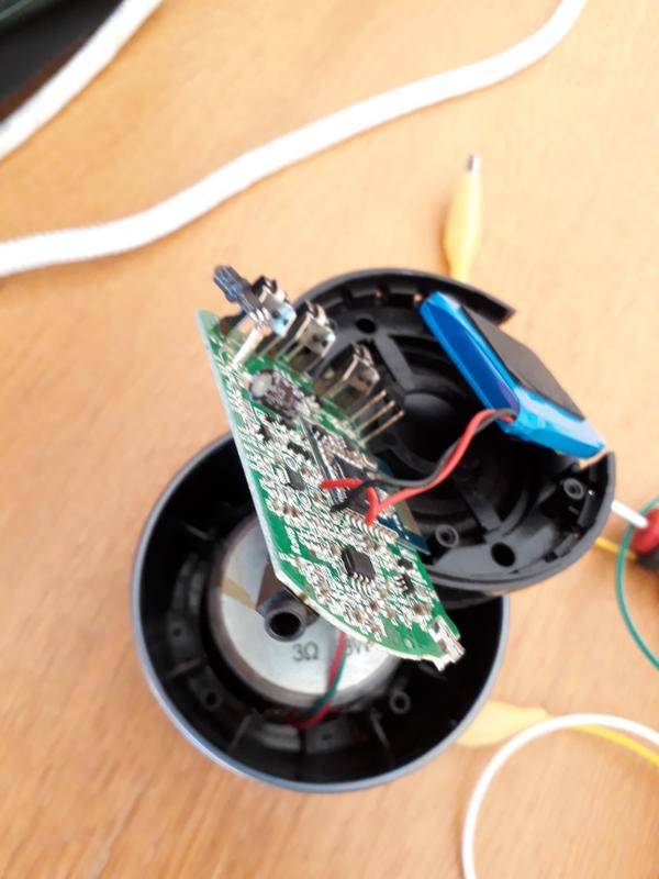

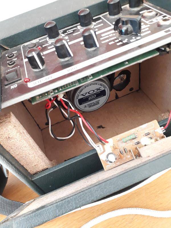

Hello, I have a guitar amplifier I'd like to convert into a bluetooth device. Using it's current power supply and allow it to receive a bluetooth input. I have a bluetooth speaker that I took the electrics from. The bluetooth speaker is digital, but when it outputs to the speaker it's an analogue signal. How could I connect the bluetooth speaker to the guitar amplifier? The guitar amplifier has an Auxiliary Port, could I just connect the output going to the speaker of the bluetooth deivce directly to the Auxiliary Port? Or would that not work.
Here are some photos of the guitar amplifier & bluetooth speaker:
Thanks :wink:

You need to look at the input specs of the Aux port. Some of types of input ports are designed to take a weak signal like microphone or guitar pickup. While the output to the speaker of the Bluetooth device has already been amplified

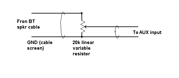

What would happen if I passed the amplified signal directly into the Aux input, would it damage something or just wouldn't work?
you would over-drive the AUX input
the easiest way is to put a level control in circuit between the BT audio out and the AUX input. That way you can set the levelso that the input isn't overloaded
here's a quick schematic I drew up

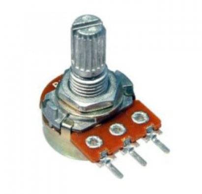

and an example of a 20k variable resistor (Pot)
Cheers
Dave
Thanks Dave, worked perfectly :)
