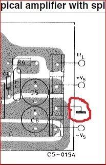

Some observations:
1) A 1V supply voltage drop is quite high for lead-acid cells. Either they are undersized, partially discharged or damaged, or you measured at the op-amp pins and have a long run of undersized wiring to the batteries.
2) C5, C6 should be in the range of 1500uF to 3300uF and placed physically and electrically close to the TDA3020 with heavy traces/wiring between the caps, the TDA3020, the speaker return line, and the battery common. This is especially true for the speaker return line. It should connect only to the speaker and the common connection of C5, C6.
3) R5, C8, as well as R4, C7 may be needed to avoid ultrasonic oscillations, You will need a 'scope to check for sure. If ultrasonics are present they will increase power dissipation, decrease audio power, probably introduce distortion, and may damage the speaker. If a 'scope is absolutely not available, you can try connecting a bulb from a single cell flashlight in place of the speaker. If it lights at all without any input signal, you have problem.
Details on point 2) above:
A "single point Ground" is needed for Grounding. This consists of:
A) A large pad (if it is a pc board, or shortest practical, heavy wire if wired) that connects the common point of C3 thru C7, the battery Common, the speaker return line.
B) Other circuit power grounds are traces that connect to that large pad.
C) Power to other op-amps on the board should come the appropriate + and - pads C5 and C6.
D) For the LPF, the input signal ground should connect to the gnd end of the 10k, the gnd end of the 4.7uF, the gnd end of R3 at the TDA3020 input, and then to the large pad of detail A), above; in that order.
Have Fun!

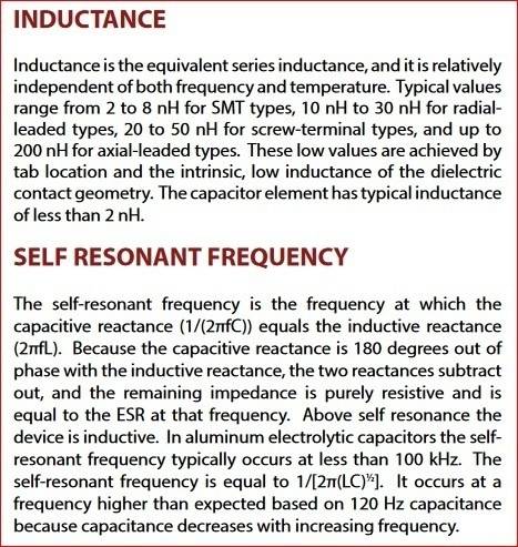

:bugeye: but the supply is a battery right? Would such huge values be required?
Except for the TDA2030, that's exactly how the design is. Thick plate-like tracks, all components not far from each other, but yeah..:doh: the TDA2030 is a bit far.. I telll you, the reason is I wanted it to be well heatsinked and easily accessible for inspection, so i mounted it on a sink and placed it near a vent in the box, this required some wiring from the PCB to the IC, about 15 cms length of 0.75mm thick single strand wires [for each lead]...
Yes all these are satisfied.
Yeah..all components are fed from the caps.:thumbup::thumbup:
Yeah. The large pad is actually the TDA2030 common ground, which is large enough to collect back all return paths- speakers return, cap commons, and supply common. This common is connected to the common grounds of filters, and the input ground goes to the grounds of the filter components as you specified. [the filters are actually one board while the Amps make up another, a total of two boards whose grounds are connected by a thick wire.]
So the trap is the wirings from the board to the IC amps?
Because, as I mentioned in #1 I have a pocket 10w soundbox made of one TDA , single supply configuration, and it's not this problematic at all. It works on the same batteries, 47uF supply bypass/regulation capacitors, no R5, C8, R4 or C7. It's crystal clear and loud as hell :biggrin:.
Here it seems only difference is the IC's not being home.
Thanks for the help and advice..

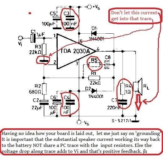

how the small tings of the Earth confound the mighty...
Woah Jim..That sounds familiar..!
Wait, it was mentioned in the datasheet yeah , oh I've ignored that too!
Thanks for pointing that!
So with all commons in place, I just need to isolate the ground of the 22k??
How do i do it?o_O

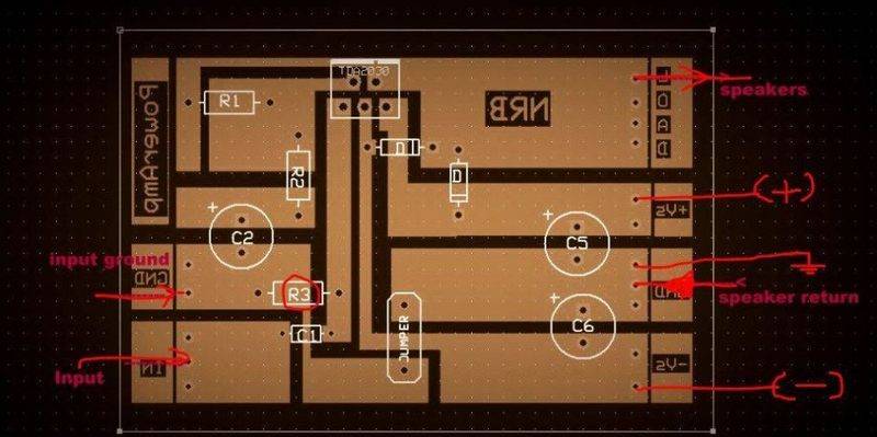

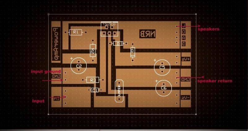

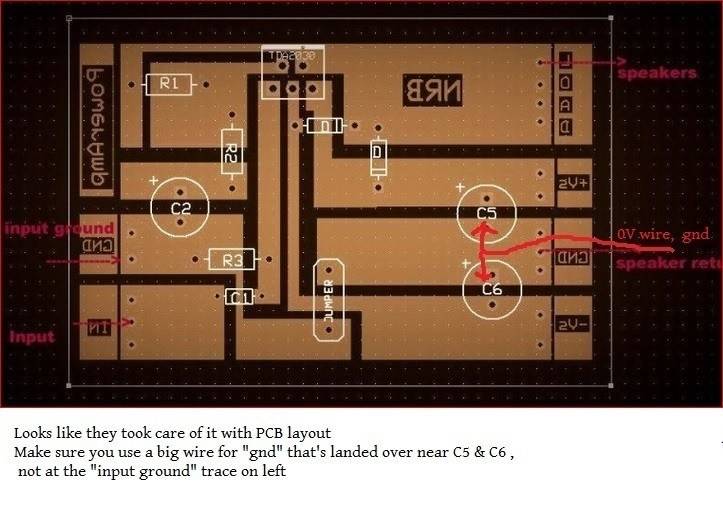

How do I isolate input ground and speaker return?
Here's the layout for reference:
Thanks again.
I assume I have to connect the supply common nearer to speaker return than the input resistor, so that the speaker return current goes into main ground as soon as possible and doesn't have a chance to enter the 22k??
I drew this conclusion:
correct me if I am wrong.
here's how they did it on their datasheet
looks like they used same terminal for both speaker return and 0V gnd . Center of their "star gnd " ?
Yeah. So my supply common goes directly to the speaker return point (star ground). I have this one correct right?
So this possibility ruled out.

PhysicoRaj said:
I'm beginning to suspect wires that connect the TDA to the PC board [#11].
i missed that statement
Tom.G spotted it quite a while back...I hope you twisted those two power supply wires to minimize their inductance.
And, i see. you have not bypassed your big electrolytics C5 and C6 with little 0.1's C3 and C4 .
That would be important even without the long wires.
It seems silly at first but it's one of those basics they forget to explain.
Electrolytics are made by rolling up a long strip of aluminum foil into a coil and placing it inside a can.
The coil gives a small amount of inductance in series wit the capacitance.
At higher frequencies that small inductance becomes significant and the capacitor looks less and less capacitive and more inductive.
That's why you see a 100 uf paralleled by a 0,1 uf. At high frequency the 100uf disappears.
So let's try something:
place 0.1's as close as possible to the amp, tack them right across its pins
since there's no ground pin on the IC , first try just one from V+ to V-,
if no luck use two 0.1's and run a ground wire to their junction, and twist that ground wire with the V+ and V- wires.
Then save and read this capacitor application guide
http://www.cde.com/resources/catalogs/AEappGUIDE.pdf

Omitting R5 -C8 extends frequency response making power supply bypass even more important
