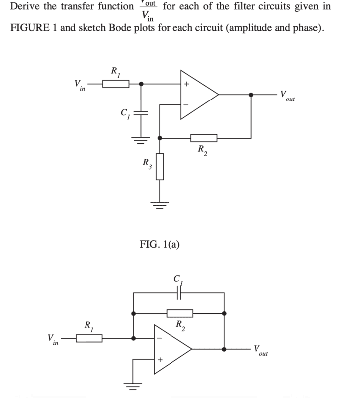

Derive a transfer function for each of the filter circuits and sketch a bode plot
Av = Vout/Vin
Hi
Can anyone help with this? I understand what the bode plots should look like but I am not sure how to produce a plot in excel for them without any values

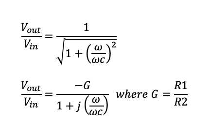

The transfer functions are:
Vout/Vin = 1/(SQRT(1+(ω/ωc)^2)
and
Vout/Vin = -G/(1+j(ω/ωc))
As both are first order filters they will have a roll-off of 20db per octave
Thanks!
edited to add transfer function screenshot (still no good with Latex :) )

It is common, when values aren't given, to plot these after normalizing the frequency. You can define the normalized frequency ωn = ω/ωc, then you generate values of ωn around 1 to plot the filter response. Then label your frequency axis "ω/ωc".
Do I just make up values for the resistors and capacitors though? I don't understand how to calculate the gain at a certain frequency without replacing the values in the transfer function with actual numbers?
You have the transfer functions which you need to plot.
You don't need R1 and R2 because you are told G = R1/R2. G is therefore a scaling factor on the Gain axis - label it 1G, 2G, 3G etc.
You don't need C because you have ω/ωc. = see DaveE's post.
It says "sketch a bode plot" so do it by hand labelling the axes to show the 3dB point. You don't need Excel.
The question is testing your understanding of the shape of a Bode plot and the importance of the 3dB frequency.
Every circuit with a 3dB breakpoint and 20 dB/decade fall off has the identical shape Bode plot.
It is only the markings on the axis which change with different circuits. One circuit, say, has a 3dB point at 10kHz and a gain of 35dB; another circuit, say, has a 3dB point of 27MHz and a gain of 19dB. The Bode plots are identical - only the markings on the axes are different.
So the question is solved by
a) sketch a generic Bode plot - without axis markings they are all identical
b) now mark the axes with the graduations for the specific circuit
In my example plots, replace 100 by ωc, 1000 by 10ωc and 10000 by 100ωc.
