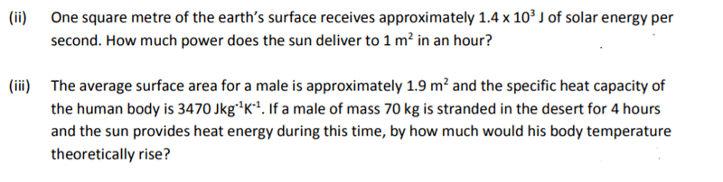

Hello, this isn't a homework or anything, I am just trying to understand one thing :) (finals are tomorrow :-0 )
If a person is exposed to heat energy of the sun for 4 hours(5040000 J per hour) and the avg surface area of the person is 1.9 m^2. and specific heat capacity of the body is 3470 J kg-1 k-1. mass of the person is 70. Calculate the rise of Temp.
Q=mc(delta T)
So here's what I am not understanding.. Should I include the person's area? but I am not seeing why they included that since the formula doesn't state area.
Answer in which area is included: (5040000*4)(1.9)=(70)(3470)T ... 158 C.
removing area from the answer: ... 83 C.

Power=Energy/time= 5040000 j/h=5040000 W
Heat energy from the sun in 4 hours= 20160000 J. my question is should we include the area to find the heat energy? if yes, why? thanks.

Nope, you're still far off in magnitude and units. Is the 20160000 supposed to be for the entire Earth? That doesn't work either.
Also, a watt is one joule per second, not one joule per hour.

So here's the 2 part question, sorry if my way of phrasing is unclear.
axer said:
[image contents converted to text]
(ii) One square metre of the Earth's surface receives approximately 1.4 x 103 J of solar energy per second
The highlighted portion of the question is important.
