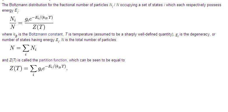

Simplistically, hemoglobin can exist in 5 states (0,1,2,3 or 4 bound O2). Name each state accordingly as UB (unbound) and B1, B2, B3, and B4 (for the four bound states). Using Boltzmann's Law, write down the probability that the molecule exists in a bound form.

The equation is actually an example of a probability distribution (the Boltzmann distribution). In this case you can think of it as the the probability that the system will be in a state with a specific energy.
First of all, remember that the probability that the system is in SOME state must be 1 (so what is Pb?) and the probability for each of the other states should be a number between 0 and 1.
What is the partition function in this case?
Also, to keep your answer as simple as possible: what is the probability that the molecule exists in the UB form?

*Look at eq. 1 on this wiki page
http://en.wikipedia.org/wiki/Maxwell-Boltzmann_distribution
This is essentially the equation above. However, look at what is written instead of your "Pb"
also look at
http://en.wikipedia.org/wiki/Boltzmann_factor
which is perhaps easier to understand and relates to the point I made above about the total probability being 1.
And yes, the different states must have different energies; otherwise they would have the same probability.
kBT will be a parameter in the final expression since you don't know the temperature.

No, not quite. Although you are quite close.
First of all: there is no way to get a numerical answer from the information you have been provided with, so I don't know where you get the "4/5" from.
The right hand side is close. However, remember that you need to normalize with the sum of ALL Boltzmann factors (there is one factor missing).
Also, the question was what the probability is that the molecule exists in bound form.
P = exp(-B/KT) / [exp(-B1/KT) + exp(-B2/KT) + exp(-B3/KT) + exp(-B4/KT)+exp(-UB/KT)]

So here's the corrected answer:
P = [exp(-B1/kT)+exp(-B2/kT)+exp(-B3/kT)+exp(-B4/kT)] /
[exp(-B1/kT)+exp(-B2/kT)+exp(-B3/kT)+exp(-B4/kT)+exp(-UB/kT)]
Is this correct?
