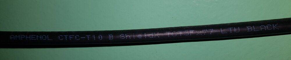

This is my cable..is it RG 6? I can't find whether it is at google.
Amphenol CTFC-T10 B ShieldX TCTSFx77-LTU

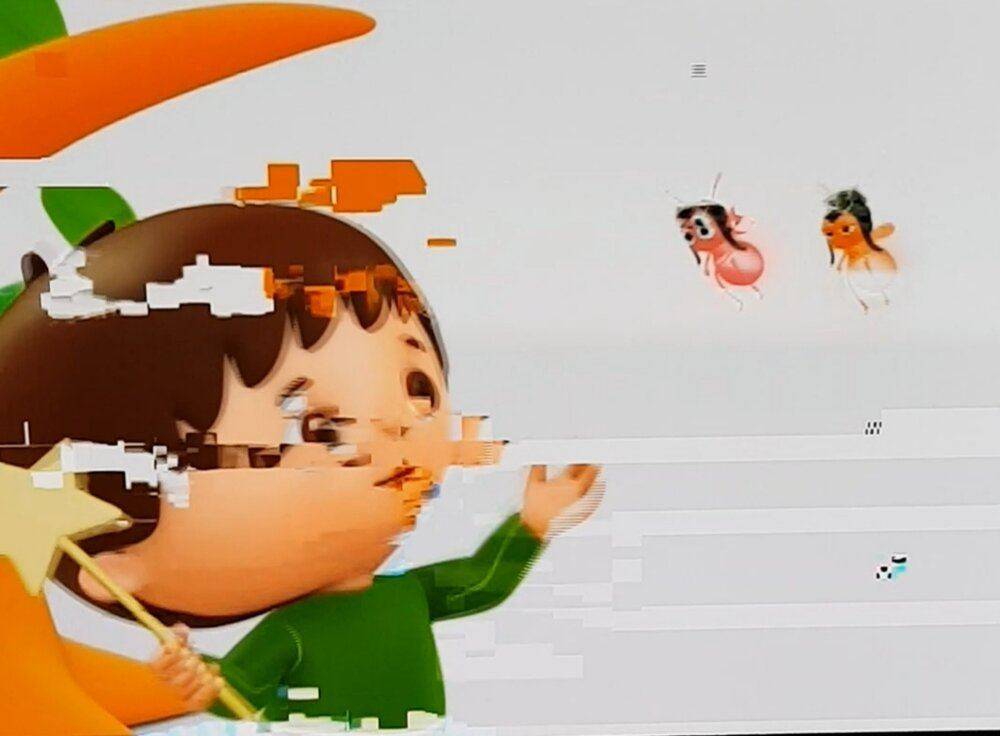

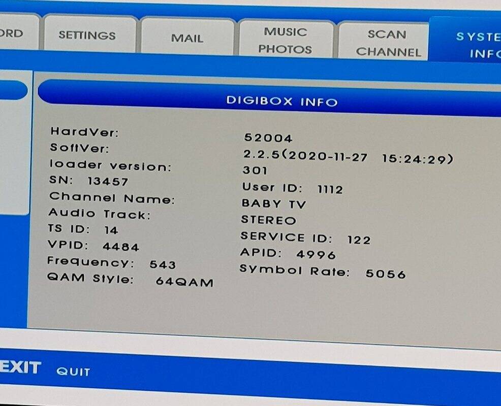

This is the image in the tv channel watched by my niece. But the other channels seem to be fine.
Television screen with heavy digital glitch artifacts showing a cartoon child in a green shirt holding a star wand, with two small cartoon bugs on the right and blocky streaks of distorted colour across the picture.
It is odd that it is only one channel. Do you have a cable company?

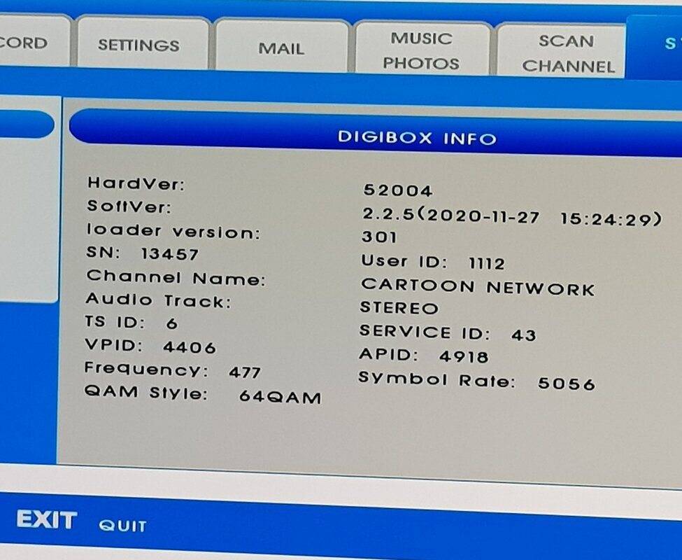

Yes. Most of the other 30 channels are ok. It is the babytv channel with problem. But my main tv at ground floor has no problem in the babytv. So its really the extension..anyway here is the signal info at babytv
Photo of a set-top box screen showing DIGIBOX INFO for channel BABY TV, with fields such as HardVer 52004, SoftVer 2.2.5, Frequency 543, QAM Style 64QAM, Symbol Rate 5056, Service ID 122, and Channel Name BABY TV.
The cartoon network channel is ok and has this spec
Set-top box DIGIBOX INFO screen listing HardVer 52004, SoftVer 2.2.5(2020-11-27 15:24:29), loader version 301, SN 13457, Channel Name CARTOON NETWORK, Audio Track STEREO, TS ID 6, VPID 4406, Frequency 477, QAM Style 64QAM, User ID 1112, SERVICE ID 43, APID 4918, Symbol Rate 5056.
Where the loss of signal quality is only on one channel frequency, the problem is often related to the length of the cable, between a poor connection with an impedance mismatch, and the receiver. For digital TV, all channels on the one frequency bearer can be expected to have poor quality.
We need to know how your cable system distributes the channels on different frequencies.

I don't know how the cable system distributes it but remember our primary tv at ground floor has good babytv signal. In the second floor, the problem only started this week. It was ok a week ago. Its not loose connections. And its difficult to rewire cable. So i want first to get a coax booster just to try what happened and test the theory booster is useless for 20 meter with corroded part. If still noises at screen then ill change the cable. So what kind of coax amplifier to get. Are there many kinds?

Do you know what can cause the following artifact? Is it the ground shorting to the middle wire, or resistance caused by corrosion in wire? Or loose connection? Since there is degradation of signal. Theoretically why won't a signal amplifier fix it?
Screenshot of a TV showing a cartoon child in green with a star wand, heavily corrupted by horizontal glitch blocks and streaks, with two cartoon insects floating at upper right.
Btw.. what is the arfifact called so I can google it? Aliasing? Video noises? Manifold defect? Topological anomaly? What?
Pixelation.
Each rectangular part of the image is painted as it changes. If data is missing a patch cannot be painted and so previous image gets left there. It shows that some blocks of received data have been damaged beyond correction, and so are lost.

Amphenol is one of the top coax suppliers, stick with them if you can.
The Amphenol Global Search page, below, that has several entries that my old computer can not talk to is VERY slow to respond. Hopefully you can get more information from them.
INSERT: Just found TFC-10;
created by(?): Times Fiber Communications http://www.timesfiber.com
also made by Amphenol: https://www.amphenol.com/gsearch/ctfc-t10?page=1
The cable you have is 75 Ohm and has a shield layer that is extruded Aluminum, not foil like the indoor ones most folks are used to. As such it is probably a little more sensitive to repeated bending. If outdoors (as it is designed for) it probably should be restrained from flapping in the wind, repeated bending may eventually crack the shield, causing signal loss. (the flapping and bending is speculation on my part, based on the descriptions on the manufacturers website)
One site says you can directly connect RG6 to the TFC-T10 with an 'F' male-male connector. Since they are both 75 Ohm you should be good to go.

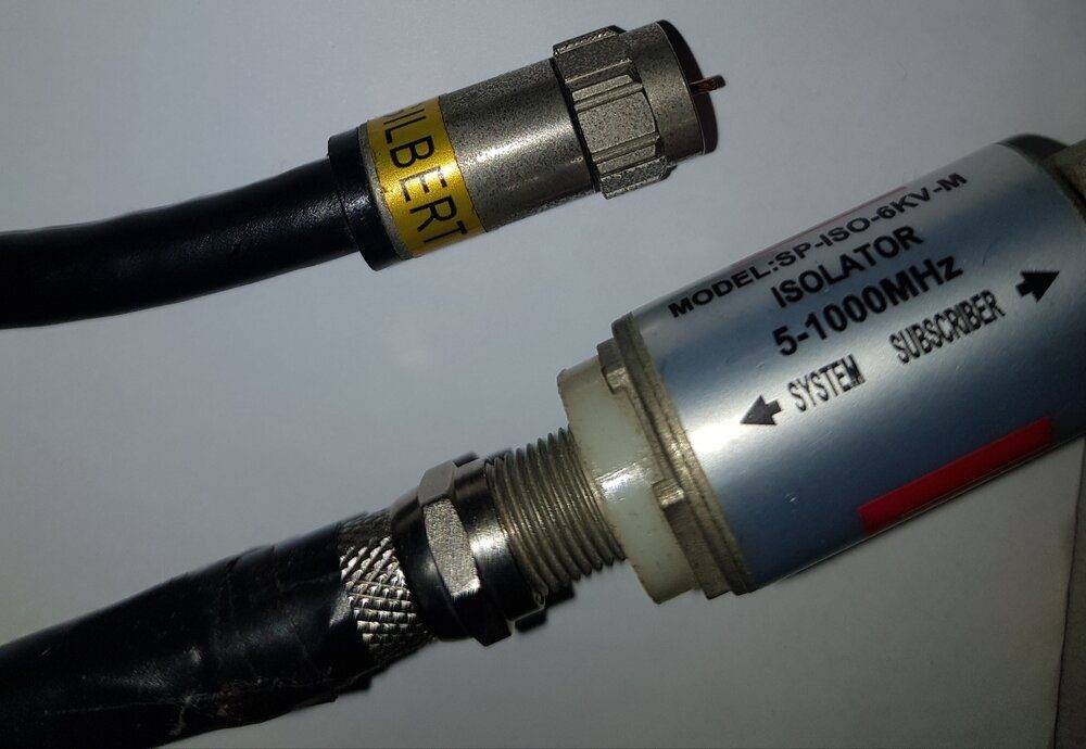

Photo of a coaxial cable with a gold-banded F connector at the top left and a silver cylindrical inline isolator on the right, printed MODEL SP-ISO-6KV-M, ISOLATOR, 5-1000MHz, SYSTEM and SUBSCRIBER with arrows.
I replaced the f connector or plug and there is still pixellation (its not the isolator because i bypassed it), in fact worse. So ill replace the whole 20 meter coax cable. Ok what is better than RG6? I won't get TFC-T10 anymore bec its more fragile. Or better yet since its only 20 meter coax. Ill get milspec coax. What kinds of coax do milspec facilities like nuclear power plant or NORAD use?
(I noticed that with the isolator, the pixellation is worse. I couldn't find any schematic of the isolator. Is there something like isolation transformer inside? Is the current stop from flowing and coupling via magnetic field, how does it work?
Also i tried to insert the center wire only. The cable tv has no signal. I read the wire shielding in the outer part of the cable is to prevent noise. In my case, it is used as ground or return signal? If 50% is broken, how would the shielding affect the center wire RF transmission?)

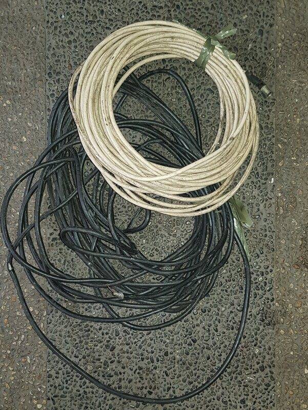

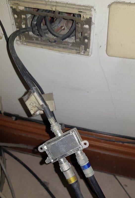

The plot (or wire) thickens. I found out the 70 meter coax cable from street to inside apartment is RG-59 (its written on the wire). It can't be pulled and replaced.
Coaxial cable entering a metal wall plate, with printed text on the jacket reading RG-59/U 75 OHMS COAXIAL CABLE, and the cable loops curving behind the plate.
Photo of a coaxial cable splitter mounted on a white wall beneath a wall outlet plate, with a black coax cable entering from above, a taped label on the cable, and yellow and blue connector bands on the outputs.
Right after it is the splitter where the right wire goes to TV (only 1 meter), while the left wire goes 20 meters to the 2nd floor (using TCF-T10 wires as Tom G. showed)
So coax amplifier is really required now before the splitter, is it not? I'll just replace the defective 20 meters with RG6 because even with Milspec golden wires, the RG-59 is the limiting factor.
What is best coax amplifier in the world? I only have one chance to buy it at amazon and won't replace it for a long time so don't want to make any mistakes. Thanks.

Remember there are 70 meters of RG59 before the 20 meters of TFC-T10. So total is 90 meters. 90 meters is not horrors length and can do without coax amplifier?
