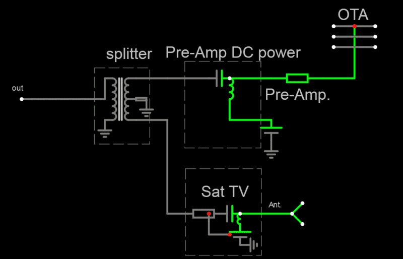

Hi
I currently subscribe to Directv, the signal is from the dish and split into 4 coax to go to 4 different rooms. So each room has a coax output on the wall to hook up to the Directv receiver box.
I decided to change to Dish Network. At the same time, I want to install a VHF/UHF digital tv antenna on the roof so I can receive local tv channels. Do I have to have Dish Network to put in a new set of cables to each room and leave the original Directv coax alone so I can use it to connect an antenna. OR can I have them combine the Dish signal and the antenna signal into the coax. Then I use a splitter to get both signals in each room?
I read Dish signal is around 10GHz, UFH is around 500MHz. It should be ok to mix the two signals through one coax and split them out later. I hate to run two separate sets of coax around the house if I can help it. Just want to know whether it is possible.
I can only receive good antenna signals in one room, no signal in the rest of the house. So a roof top antenna is the only option. I just want to confirm that. Also, will the Dish Network installer be able to combine the signal for me? Or I can get an antenna installer later to run the signal into the Dish coax?
Ha ha, I am afraid of height, there's not way in the world I would go up to the roof to do anything myself. Or else I would just do it. I have to rely on other people to do it. So I have to be careful and clarify everything first.
Any reading material you can give me a link will be helpful. Somehow no matter how I type, search engine keep giving me "combine cable internet with antenna". I can't find satellite dish signal.
Thanks
Alan
There is a safer compromise. Run the two services in two separate cables until they enter the house. You can then test each independently, and so avoid finger pointing should one fail. Once installed, you can use a combiner or a physical switch in the house, to feed the one internal distribution line.

Theoretically, yes. Of course you will need filters, splitters, combiners and such. But I think @Baluncore is right, keep them separate enough so that you aren't interfering with the providers system, both for simplicity, troubleshooting, and practical issues dealing with the telecom field service guys. In any case, I would design your system so that you can easily reconfigure the normal telecom installation to demonstrate to the FSE that it's their problem to fix, not caused by you.

The signal-efficient combiner at the antenna, and the splitter at the bottom of the cable will be very similar devices, if not the same reciprocal device.
Another complexity of a single cable, would be feeding DC power up one cable to power the masthead electronics and switches of two or more systems.

As an aside, have you thought about how 4 separate rooms will control the direction and gain settings for your rooftop DTV antenna? You'll likely need to have some central control station in the house, once you map out the various DTV stations in your area, no?
https://www.fcc.gov/consumers/guides/antennas-and-digital-television
as for the DC over coax to feed the dish head, how about putting a sufficient capacitance to block the DC from going back out into the local area TV coax cable?
Otherwise I don't see why a simple splitter/combiner wouldn't work, it should, as long as the ends have the proper demodulation apparatus like a decoder for the local Tv and one for the dish, as they do already.
I suggest you get a 20 dB pre-amp and OTA antenna away from nearest towards but towards weakest tower. Then this will enhance coverage and compensate for each 3.5 dB splitter loss in home.
