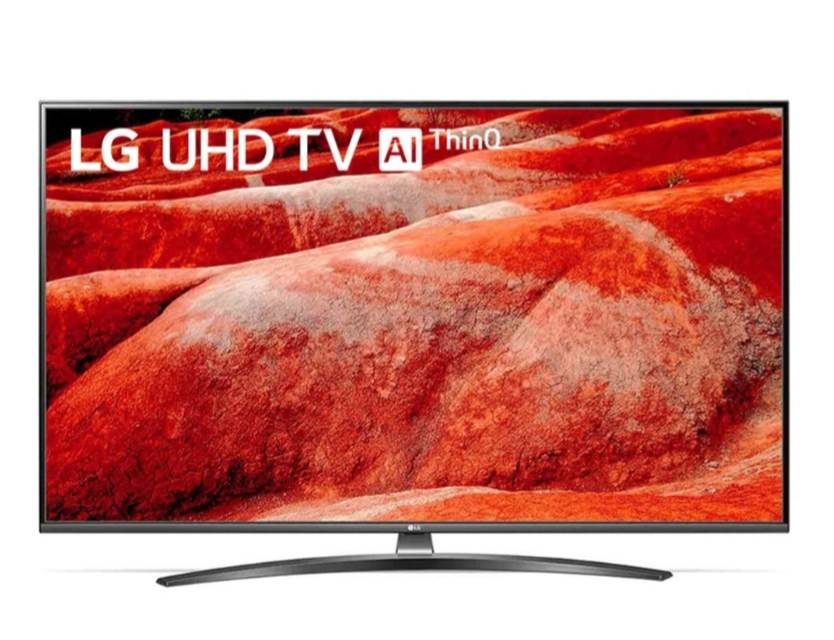

jake jot said:
My tvs are 55" 4K Hdtv hanged in walls. Its so heavy to carry in between floors. Its like this.
https://www.lg.com/levant_en/tvs/lg-55UM7660PVA#none
I have changed and switched the splitter too. Later ill try decades old RG-59 wires (removed from house put by previous tenants) kept in boxes in the attic to see if the pixellation would be gone.
