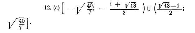

The answers according to the text are : (a) ## m \in \left[ -\sqrt{\frac{40}{7}} ; - \frac{1+\sqrt{13}}{2}\right ) \cup \left(\frac{\sqrt{13} - 1}{2}; \sqrt{\frac{40}{7}} \right ]## and (b) ## m \in \left[ -\sqrt{\frac{40}{7}} ; \frac{1-\sqrt{13}}{2}\right ) \cup \left(\frac{\sqrt{13} + 1}{2}; \sqrt{\frac{40}{7}} \right ]##.

(a) Given that both roots are less than 1 : If ##[\alpha,\beta]## be the two roots of the equation and ##\alpha ## be the larger of the two roots, then this condition implies ##\alpha < 1 \Rightarrow \frac{-m+\sqrt{m^2-8(m^2-5)}}{4}<1 \Rightarrow -m+\sqrt{m^2-8(m^2-5)}< 4 \Rightarrow \sqrt{m^2-8m^2+40} < 4+m \Rightarrow \sqrt{40-7m^2} < 4+m \Rightarrow \ 40-7m^2 < 16+8m+m^2 \Rightarrow 8m^2+8m -24 > 0 \Rightarrow m^2 +m - 3 > 0##.
This leads to ##m > \frac{-1\sqrt{13}}{2}\; \text{OR}\; m < \frac{-1-\sqrt{13}}{2}##.
Combining this with the earlier requirement for positive-definite discriminant, we obtain the answer for (a) which matches with that in the book :
##\boxed{m \in \left[ -\sqrt{\frac{40}{7}} ; - \frac{1+\sqrt{13}}{2}\right ) \cup \left(\frac{\sqrt{13} - 1}{2}; \sqrt{\frac{40}{7}} \right ]}##.
