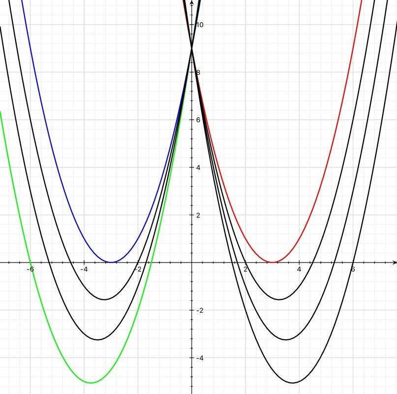

This was my way: in part it is "back to basics" and I like the way the factors of the discriminant emerge separately.
Call this quadratic ##P(k, x)## ; it can be written
$$P\left( k,x\right) =\left( x-3\right) ^{2}+2kx$$
We easily see that there is a double root (##x=3##) when ##k=0## (red curve below) and two (positive) real roots when ##k<0##.
The quadratic can also be written
$$P\left( k,x\right) =\left( x+3\right) ^{2}+2\left( k-6\right) x$$
We also see that it has a double root (##x=-3##) when ##k=6## (blue curve) and two real roots when ##k>6## . Both of the algebraic factors of the discriminant, ##k## and ##(k-6)## have now emerged.
Note every curve ##P(k, x)## of the system has a mirror image ##P(k', -x)## also in the system for which ##k'=-(k+6)##. Several of them illustrated below.
Curves occupying most of positive side are for ##k=0 (red), -0.25, -0.5, -0.75##; those mostly on negative side ##k=6 (blue), 6.25, 6.5, 6.75(green).Real roots of ##P## are either both positive or both negative. You can see this from the fact that all the parabolas pass through the fixed point ##(0, 9)## or otherwise. So we don't have to worry about the interval ##-6≤x≤1## but only ##-6≤x<0##. It is very easy to show that no curve of the family intersects any other except at the point ##x=0##. You can maybe see that hence that one negative root must be less than and one greater than ##-3##. The limit x1=-6 set for the lower root gave us ##k=\dfrac {27}{4}##
$$P\left( \dfrac {27}{4},x\right) =x^{2}+\dfrac {15x}{2}+9$$
Already knowing ##(x+6)## is a factor of this we easily factor it into
$$\left( x+6\right) \left( x+\dfrac {3}{2}\right) $$
and conclude that the greater root is ##-3≤x≤-3/2##
As for the interval ##0<x≤1##, the quadratic can have one root in this interval but the second one would be >3, so the set conditions are not satisfied in this interval.
Hope this helps.
