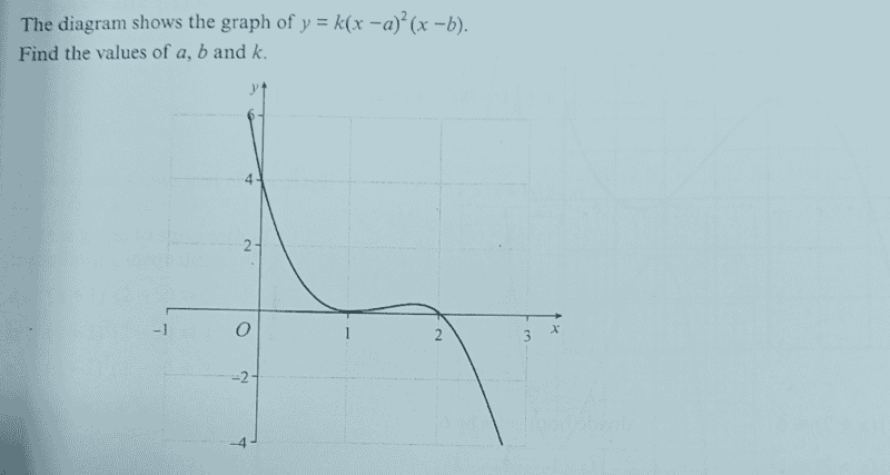

In my approach i have the roots of the equation being ##x=a## and ##x=b##.
There are two assumptions,
In the first assumption,
##a=\dfrac{1}{2}b##
##2a=b##
then,
##4=k(-a)^2(-2a)##
##4=-2ka^3##
##⇒ -2=ka^3##
Now since ##2a=b## then ##a=1, b=2⇒k=-2##.
our equation becomes,
##f(x)=-2(x-1)^2(x-2)##
checking using,
##f(1.5)=-2(1.5-1)^2(1.5-2)=0.25>0##
Now to the second assumption,
Let
##b=\dfrac{1}{2}a##
##2b=a##
then,
##4=k(-2b)^2(-b)##
##4=-4kb^3##
##⇒ -1=kb^3##
Now since ##2b=a## then ##b=1, a=2 ⇒k=-1##.
Our equation becomes,
##f(x)=-1(x-2)^2(x-1)##
checking using,
##f(1.5)=-2(1.5-1)^2(1.5-2)=-0.125 <0## which is a contradiction as ##y## is positive between the roots ##x=1## and ##x=2##.
Therefore the second assumption does not apply. We shall therefore have the unknown values given by:
##a=1, b=2, k=-2##.
There may be a better approach.

Did you graph your answers to see which is right?
Hint: Double roots "touch" the x-axis, whereas single roots cross it.
Which is your double root?
-Dan

I think i have shown that the second possibility does not apply thus we can only have the first possibility as the correct approach.
Kindly follow my working.

You asked for a better method. What Dan's saying is that ##\dfrac{dy}{dx}(x=a) = 0##, so the double root at ##x = a## is a turning point. That gives you ##a = 1## directly.

@chwala, your solution is much more long-winded than is necessary. One can see by inspection of the graph that a = 1 and b = 2. The equation is therefore ##y = k(x - 1)^2(x - 2)##.
Since the y-intercept is 4, k can be determined by solving the equation 4 = k(-1)(-2).

I do not think it was that straightforward. How to answer the question on script (by inspection )if it was an exam question? ...using complete square knowledge to justify ##a## as a turning point of graph I suppose.

It was straightforward to me. You were given the equation ##y = k(x - a)^2(x - b)## and shown that the graph has x-intercepts at x = 1 and x = 2. I'm assuming that these are the exact values, and I'm sure that was the intent of the writer of this problem.
The facts that 1) the graph had a parabolic shape that opened upward near x = 1 and 2) crossed the x-axis at x = 2, told me that the quadratic factor had to be ##(x - 1)^2## and that the linear factor had to be ##(x - 2)##. Being able to recognize the behavior of low-degree polynomials is a skill that is often taught as part of precalculus courses.

Completing the square, if that's what you meant above, isn't helpful. The equation is already given as a product of factors.
