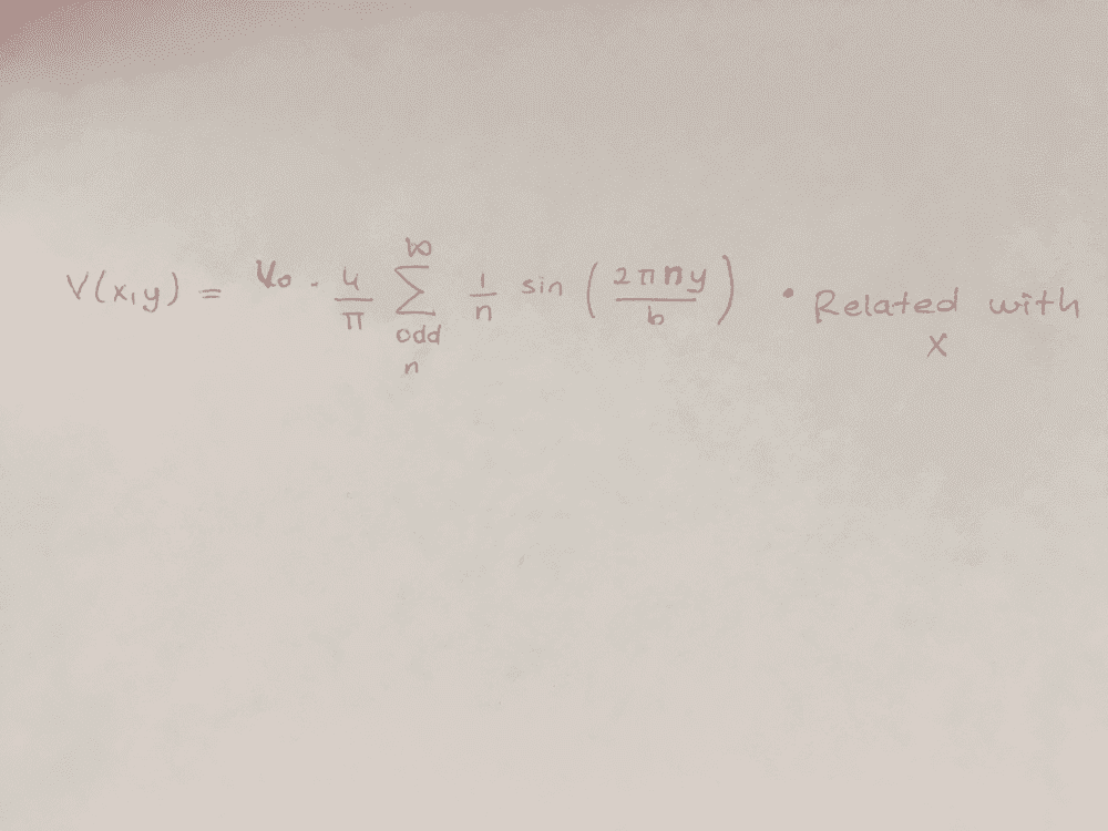

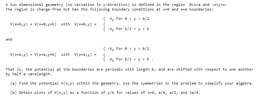

Hello,
I have a question about the potential. I think the potential shoul be something like below. In that way periodic behavior work perfectly. But I don't know how to add the x variable to the equation.
So how can I find potential?
Text problem statement: two-dimensional geometry with region 0<x<a and -∞<y<∞, charge-free, with periodic boundary conditions V(x=0,y)=V(x=0,y+b) and V(x=a,y)=V(x=a,y+b), piecewise potentials Vo and -Vo over y ranges b/2 and b, followed by parts (a) and (b).
Handwritten equation: V(x,y) = V0 · (4/π) Σ (odd n, n = 1 to ∞) (1/n) sin(2πny/b), followed by the note "Related with X".
  • Handwritten equation: V(x,y) = V0 · (4/π) · sum over odd n from 1 to infinity of (1/n) sin(2πny/b), followed by the note 'Related with X'.
Well this amounts to solving a Laplace equation for potential, right?
$$\Delta \phi = -\frac{\rho}{\epsilon} = 0$$
I would solve this 2D Laplace equation for a rectangle defined by ##0<x<a## and ##0<y<b##. Then once you have the potential inside that rectangle, you would periodically extend it over ##y##. I assume you're familiar with this equation since you're asking this kind of a question, if you're not, I can give you some introduction to it in the next post.
