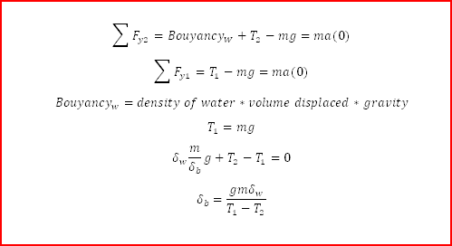

You have two scales with a weight suspended from them on a string. Scale one has a tension of T1 and scale two has its mass submerged in water with tension T2. If you have T2<T1, find the density of the weight in terms of only density of the water, T1 and T2.
Density = mass/volume
Volume = mass/density
mass = density*volume
Buoyancy = Density of liquid*Volume Displaced*gravity
Hi new to the physics world and the symbiology is hard to understand completely. Attached is the work I've done to a final solution but I can't seem to get the answer in terms of only density of water and T1 and T2. Thank you for any assistance.

-- in this context I propose you create a variable ##V## for the volume of the weight. Definition of density ##\rho## (using a ##\delta## is confusing to others) is ##m = \rho V## . Rings a bell in the algebraic treatment ? [edit] greyed out after a cup of coffee and a decent read of your word doc :smile:
[edit] never mind, you are nearly there already: your last line reads $$\rho_b = {mg\; \rho_w\over T_1-T_2}$$ and to get it in the required form, you need something else for ##mg##. Guess ...

Thank you for that insight. With that I do get the correct answer with replacing the mg with T1. However, is there a way to manipulate the equation without just replacing that mg with T1? Again thank you for the insight!
