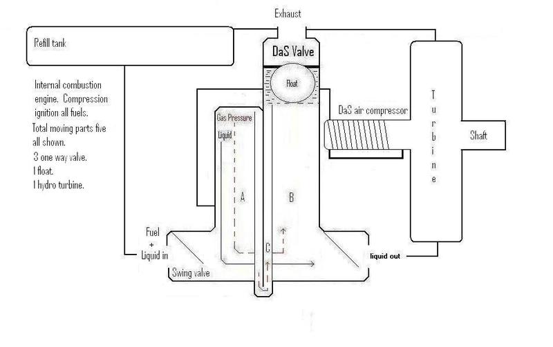

Not sure if this of any help but it works.
We have had it going but no one seemed interested so we switched over to internal combustion.
Its uses the same design as for the pistonless IC engine. However the air compressor becomes the the suction/compressor found in fridges.

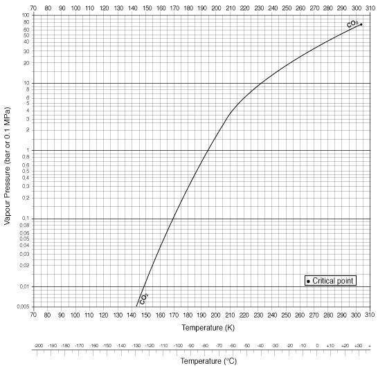

The refill tank also becomes Co2 gas compressor to orice and expansion chamber as in "Eienstein" fridge, this occurring by rising water level from turbine discharge and the compressor becomes vacuum pump drawing cool Co2 back into the combustion cylinder which is instead heated.
Working temperature begins at minus 10* celsius.
References to heat/pressure Co2 are aplenty on the web.
Power output is suppled by California University. 9 bar pressure at flow of 1 litre per second generates 720 watts. Increase in either pressure or flow increases wattage output.
I am no engineer just old bush folk and happy to supply all as I have given it over to all as Open technology.
Sorry about the combustion example, will draw again in low heat turbine configeration should your interest be such.

Should around 1KWe be all your seeking, no compresser is needed, ambient cooling will cut back on costs by and be far simpler to make.
The refill tank accepts hot Co2 from exhaust, which in fact speeds the DaS Valve refill.
New incoming water from the turbine lifts the held water in return tank forcing the hot Co2 into cooling line which feeds back into the shorter cylinder being heated.
2 litre flow per second at 9 bar pressure produces 1,440 watts. 9 bar pressure being minimum pressure required to obtain full operation of turbine generator.

Note earlier atachments (hopefully) Co2 pressure/temperature scale. Example Co2 +10* Celsius 20 bar pressure Co2 +30* Celius 70 bar pressure. Pressure force going to T..C will be 50 bar.
