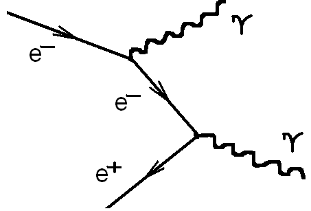

I think that the Breit-Wigner formula applies to reactions going through the s-channel (because E describes the CM energy, which is \sqrt{s}).
The tree level diagram for e--e+ annihilation (e^{-<br /> }e^{+} \rightarrow \gamma \gamma) is the following:
As you can see, this is a t-, or a u- channel process, so the formula does not apply. Also the intermediate particle is a fermion, not a photon.
