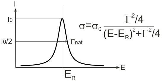

Hi, in short:
E_R is the position of peak. E is the complete range (i mean x-axis).
when you draw a Lorentzian, E in x-axis and for your formula E_R means the position of the peak.
If you have 2 peaks then there will be 2 E_R.
If you dealing with cross section, then the first term in your formula is just the nuclear cross section (or it is just the height of the peak).
see picture
it is better so see this picture
