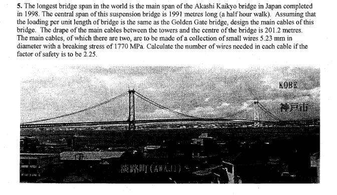

I have gathered all the information:
Span: $1991$ m
Breaking Stress: $1770$ MPa
Load: $370$ KN/m
Drape: $201.2$ m
So far, I've found the allowable stress by dividing the breaking stress by the safety factor, which is $787$MPa. Then, I calculated the total load of the bridge, by multiplying the span, with the load: $737 000$ KN.
Then I divided it by two, because each tower is responsible for 1/2 of the load. Now I am stuck, any ideas?

So right now, what I did is finding the vertical force of the bridge, by $\frac{wl}{2}=\frac{370 \cdot 1991}{2}$
The horizontal force is given by $\frac{wl^2}{8h}$, which can be calculated by examining the moments on half the bridge...
Then I calculated the net force by applying pythagorean theorem. I know that stress = $\frac{F_{total}}{nA}$, so that is dividing the total force by the number of wires, and each of them should be equal to the allowable stress. Now, is that right? I don't think the bridge is still held by a single thread (Giggle)
Actually, I misread the problem statement originally, so my comment about a single thread is a off.
Sorry for that. :oBefore we get confused, let's define a couple of symbols.

The weight of the bridge section is:
$$W=wl$$
And indeed, this gets divided over the 2 towers.
So that leaves us with a vertical force on a tower of:
$$V=\frac 12 W = \frac{wl}{2}$$
Good!
I'm not sure how you examined those moments, but the horizontal force is indeed:
$$H=\frac{wl^2}{8h}$$
So we get indeed that:
$$F_{total}=\sqrt{H^2+V^2}$$

I'm going to proceed by steps, just to make it is all correct.
$$V=\frac{wl}{2}=\frac{370 \cdot 1991}{2}=368335 \text{ kN}$$
$$H=\frac{wl^2}{8h}=\frac{370 \cdot (1991)^2}{8 \cdot 201.2}=911226.373 \text{ kN}$$
$$F_{net}=\sqrt{V^2+H^2}=\sqrt{368335^2+911226.373^2}=982855.114\text{ kN}$$
I'm going to be very careful with my units in the next step:
$$\sigma_{max} = \frac{F_{max}}{nA}=\frac{982855.114 \text{ kN}}{\pi \left(\frac{5.23}{2}\right)^2\cdot 787 \text{ MPa}}=58132.84 \text{ wires}$$
Remembering this the the number of wires in both cables...we can divide by two to arrive at $29067$ wires. Is this right :D?
Yep!
Strain does not have $\text{wires}$ as unit. :eek:
Did you mix up $\sigma_{max}$ and $n$? (Wondering)
Since the problem statement asks for the number of wires you need for each cable, yes, you can divide by two. (Nod)
For the record, I'm getting $29079$.
Did you make a rounding error? (Crying)
Since we have the first 3 digits in common, where did you round an intermediate result to 3 digits?

Yep, I did mix up both stress and number of wires by accident, but I did recheck my calculations, and I did indeed get 29066.41799 wires.
$$n_{wires}=\frac{982855.114 \text{ kN}}{\pi \left(\frac{5.23}{2}\right)^2\cdot 787 \text{ MPa}}=58132.84 \text{ wires}$$
I do understand that the bridge is symmetrical and everything, but it still confuses me. If we only look at half of the bridge, and examine only the vertical and horizontal forces acting on half the bridge, we determine the net force acting on half the bridge. Shouldn't the number of wires be reflecting the number of wires on only half the bridge? So if the net force was $982855.114$, then the net force of the whole bridge is that times 2...
Your rounding error is most likely in $787\text{ MPa}$, which you calculated and rounded down to 3 digits prematurely.
Anyway, it's not a big deal. (Wink)
The tensional force in the cable is not equally divided along its length.
The closer you get to a tower, the greater the tensional force, since it carries more of the bridge below it.
If the cable would break, it would be close to a tower, where the force is greatest.
More to the point, in the free body diagram (that I hope you have drawn ;)), we have a weight going down, and a vertical force at each of the towers, that are both half of the weight.
The weight of complete bridge section is carried where the wires are connected to the left tower and where they are connected to the right tower.
So where the wires are connected to the left tower, they have to carry half the weight of the bridge, and where the (same) wires are connected to the right tower, they again have to carry half the weight of the bridge. (Nerd)
