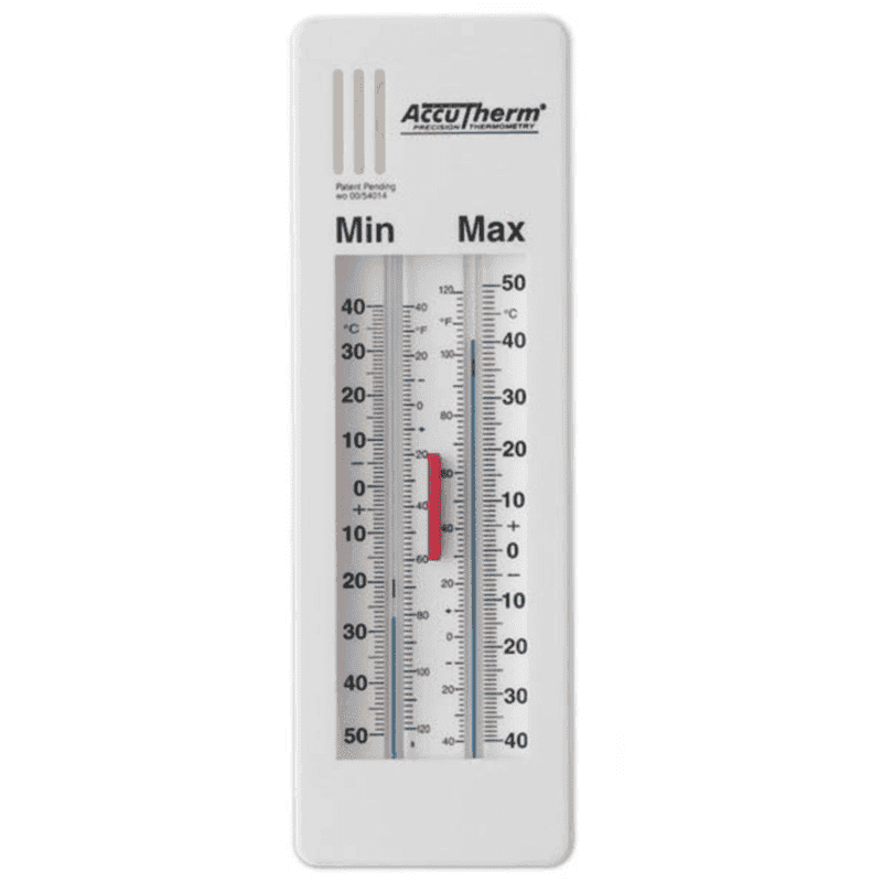

Does it need to record more than one cycle, and does it need the variation over time or just the extrema?
(I think I know where you're going. Min-max thermometers have a simple mechanism with two plugs that get lodged at the min and max points. An analogous contraption could be set up for water levels.)
My primary interest is in the timing of peaks (because the period is directly related to the shape of the body of water). But there may be several seiches overlapping, so seeing the variation over time would highlight them all.

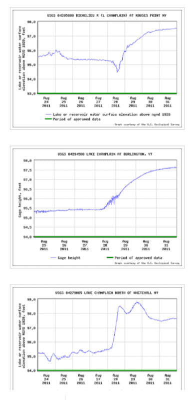

Below is an extreme example from Lake Champlain (my favorite lake) during the passing of hurricane Irene in 2011. The three plots show lake levels north, central, and south on this 111 mile long lake. The level did not return to the initial value, because there was a lot of rain in addition to the wind driven seiche. Sorry for the fuzzy pictures, the vertical scale is 93 feet to 98 feet.
I remember that example well because I rode it out on the lake at anchor without problem, and this graphic was from my blog. A more extreme example was the day when Lake Erie was 27 feet higher in Toledo,OH than at Buffalo, NY.
