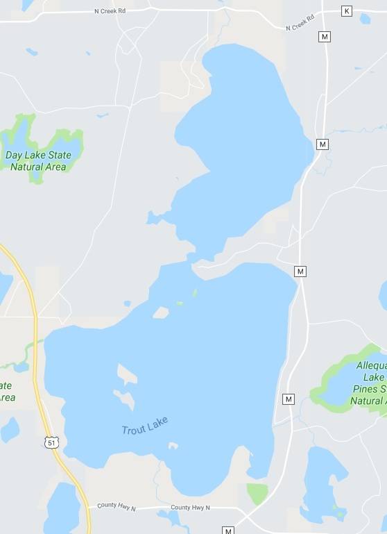

We measured several seiche frequencies in Trout Lake, located in Vilas County, Wisconsin, USA. None of those frequencies were close to the frequency from that equation. But that lake is not even close to rectangular. The measurements were at the south end of the lake and taken last summer.
Thanks. Although my prediction is off by an order of magnitude.

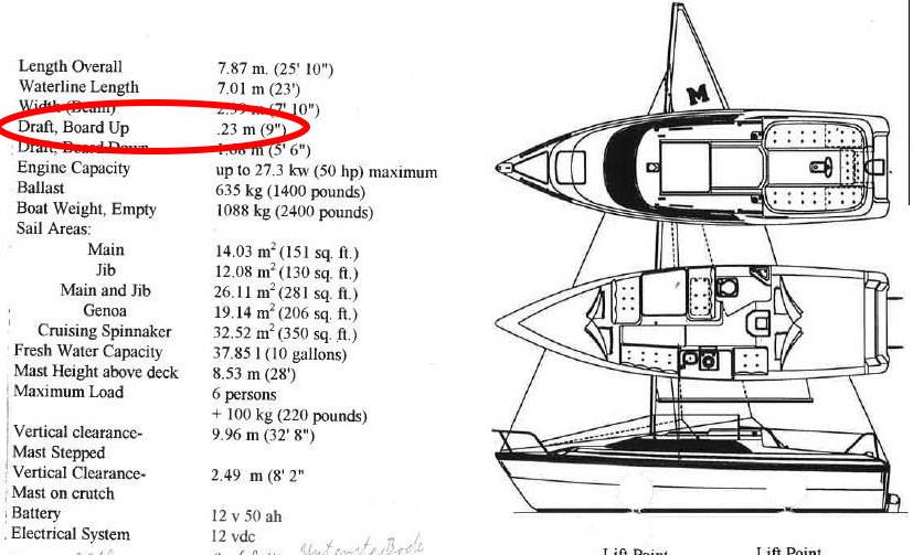

Btw, when I solved for the depth of the Long Pond using your original numbers, I got a depth of 7 cm.
depth = (2 * L / T)^2 / g
depth = (2 * 1330 m / 3220 seconds)^2 / g = 0.07 meters = 7 cm
A tad shallow for your sailboat.
But only a tad... :)
