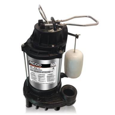

At any rate, I think the way I'll sense pump # 2 (which has an attached, non-adjustable, hardwired float) like this:
https://www.ridgid.com/us/en/1-2-hp-stainless-steel-dual-suction-sump-pump
is by attaching a metal rod or stiff wire to that switch arm to a micro-switch. That arm has hysteresis to it, the float flips it up and it stays up/ON until the float slides down that rod and pulls it down and it 'snaps' OFF.

I'm leaning to a micro-switch for the 2nd pump (the battery back up pump has a relay output I can use). It just seems the simplest at this point. But I appreciate any and all suggestions, it's good to get the mind thinking.

Sorry, didn't see the reply - yes, I understand, an external box would do the trick. For other reasons, I'm going to try the micro-switch on the pump#2, and if that isn't simple, I'll take this approach.
