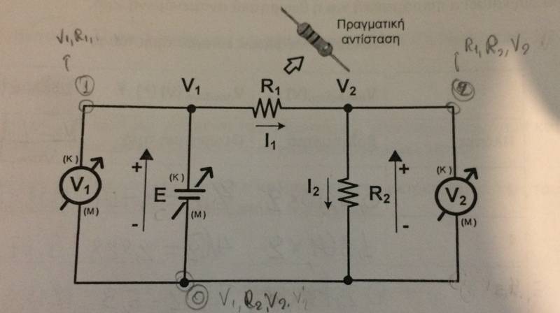

I've got the following Circuit:
Circuit schematic with two voltage sources V1 and V2, a battery E, resistors R1 and R2 and current arrows I1 and I2, with node labels 1, 2 and 0 and handwritten annotations.
And I have to make it in Spice.

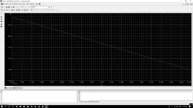

Ah, I see. As for source, you mean adding the ".op" command? They didn't tell us to add that over at the Lab, but I went ahead and tried it earlier (I saw an example on a leaflet they gave us, and it had that) and still get the same error.
EDIT: I put V1 as the "Source", right after lin:
Circuit Of Ex1
*Circuit Topology
V1 1 0 dc 0.1
R1 1 2 4.7k
R2 2 0 4.7k
V2 2 0 ac 0.05
*Types Of Analysis
.op
.dc lin V1 500 10k 1k
*Output Statements
.probe
*Termination Control Statement
.end
and I get this graph I(V1):
db1d3485-8e65-491d-81a4-e020e88d1218
Screenshot of a PSpice A/D plot window showing a nearly straight descending line from about -0.4 at V1 = 0.5 to about -2.0 at V1 = 9.5, with the vertical axis labeled I(V1).
Is it correct?

Techno_Knight said:
Is it correct?
I can't say... I don't know the specifics of what it is you're trying to achieve. Do you have a description of the Lab that explains what the goals are?
I note that both V1 and V2 in your schematic are shown as variable sources, and so is whatever component that is with the 'E' beside it. I suspect that there is more to this exercise than just sweeping the value of V1.

Is it possible that V1 and V2 are meant to be voltmeters and the E labeled component the variable voltage source? Then you would be analyzing a simple voltage divider circuit.
Actually yeah, that's what the fine print under the image says. Does that mean I have to change anything in SPICE or am I all set?
Since your netlist defines both V1 and V2 as voltage sources, yes, you need to make changes. Remove the line that defines V2, and let the V1 line define the actual source (labeled "E" on the schematic).

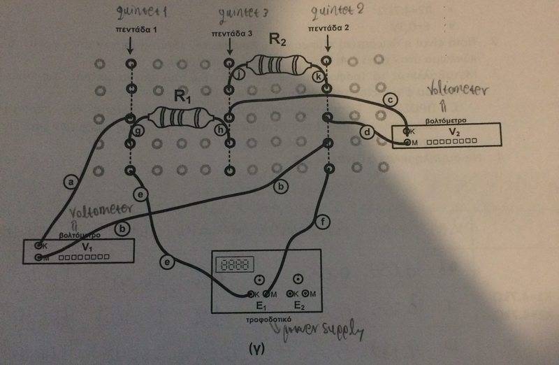

This is the "blueprint" we used to construct it in the Lab:
Wiring diagram on a breadboard grid showing two resistors R1 and R2, a power supply labelled E1 and E2, and two voltmeters V1 and V2, with connections labelled a through f and the rows labelled pentada 1 to 3.
  • Wiring diagram on a breadboard grid showing two resistors R1 and R2, a power supply labelled E1 and E2, and two voltmeters V1 and V2, with connections labelled a through f and the rows labelled pentada 1 to 3.
Okay, from what I can see V1 and V2 are voltmeters. Assuming that they are essentially ideal meters, they will not affect the circuit behavior; they only monitor the circuit. When you simulate the circuit you can take the same "readings" by other means.
The circuit you are simulating looks like this:
Circuit schematic of a series loop with a voltage source E on the left, resistor R1 4.7 kΩ on top with current I1 and I2 labelled, resistor R2 4.7 kΩ on the right, and voltages V1 and V2 marked with red arrows.
V1 and V2 are the potential differences of interest.
You should implement only the single source E and the two resistors in your simulation. It's fine if you call the single voltage source V1, since as it happens the meter reading it is also called V1 :smile:
