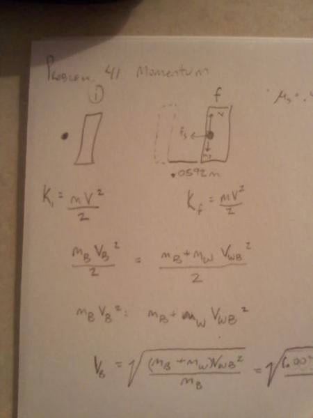

A 7 g bullet is fired into a 13.43 kg wood block that is at rest on a wood table. The block, with the bullet embedded, slides 5.92 cm across the table. What was the speed of the bullet?
Ki=Kf
ma=N+mg+fs
Xf=Xi+(Vf^2-Vi^2)/2a
I am not sure how to solve this because i am not given a coeffieicent of friction of wood on wood. I tried one that i found online (.48) but it didnt work then i tried .25 and that didnt work either. I thought i need this so i can find the acceleration so i can find out delta t so I can find the velocity of the wood with the bullet in it. But i came up with this equation to solve for the velocity of the bullet...
Handwritten physics solution titled Problem 41 Momentum, showing a block diagram with friction force fs and a 0.0592 m slide distance, then kinetic energy equations Ki = mV^2/2 and Kf = mV^2/2 and momentum-based algebra for the bullet speed VB.
Mb= mass of bullet Mw= mass of wood
Vb= velocity of bullet Vw=Velocity of wood
You know that during a collision, momentum is conserved:
p = p' (' means final)
(Mbullet)(Vbullet) = (Mblock+bullet)(Vblock)
Also, AFTER the collision, conservation of energy takes place, so:
Et = Et', initially, the block only has kinetic energy, and finally, it comes to rest, so kinetic is converted to thermal:
1/2(Mblock+bullet)(Vblock)^2 = (mew)(Mblock+bullet)(9.8)(0.0592)
I don't know why wou weren't given the coefficient. But if you find it, you can get the final speed of the block, and sub it back to find initial speed of bullet. I don't know, that is the only thing I can think of...
So i do need it, there is no other way to solve this without being given the mu.
