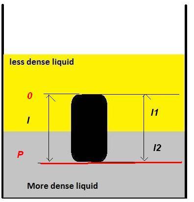

A less-dense liquid of density ρ1 floats on top of a more-dense liquid of density ρ2 . A uniform cylinder of length l and densityρ, with ρ1< ρ<ρ2, floats at the interface with its long axis vertical.
What fraction of the length is in the more-dense liquid?

Hello, I am kind of stuck on this question too (well I have an answer which I am not too sure about)
http://img27.imageshack.us/img27/3685/lratio.jpg this is a simple diagram that I drew.
Let F1 be the Buoyant force of less dense liquid and it is pointing downwards
while F2 is the buoyant force of more dense liquid is pointing upwards.
Since it is floating in middle I have assumed it to be at equilibrium, and hence F2= F1+ FG
I have used A as the area of cylinder since it is same for all regions. l1 for length of cylinder in less dense liquid and l2 for the length of cylinder in more dense liquid.

The hydrostatic pressure must be the same along the red line in the figure. The red line is at depth l=l1+l2 with respect to the top of block. The change of the hydrostatic pressure from zero to depth l is either ρgl or ρ1gl12gl2. The two pressures must be equal.
You have to express l2/l in terms of the densities. For that, use that l1=l-l2.
ehild

I understand what you mean, but I can't seem to solve l2/l easily, the answer I got was l2/l=(ρ-ρ1l+ρ1l2)/(ρ2l2)
I think I have made a mistake somewhere. I started by setting ρgl = ρ1gl12gl2
divided both sides by g, took ρ1l1 to other side of equation giving me ρl1l1 = ρ2l2, then used l1=l-l2
and divided both sides by l to get l2/l.
That lead me to l2/l=(ρ-ρ1l+ρ1l2)/(ρ2l2) but I still have l2 on both sides of the equation.
Any obvious error sources that you can see?
Regards
It is wrong from here. When you take a term to the other side of the equation, the sign will change. Substitute l-l2 for l1 first, collect the terms with l1 at one side of the equation, and the terms with l on the other side.

Hi, sorry I had - minus sign in my hand written workout, for some reason I must have put a plus sign, another one where I only put l1=l-l2 at the end lead me to l2/l=(ρ-ρ1(l-l2))/(ρ2)
Still end up with l & l2 on both sides for some reason
I will upload hand written workout in a few hours

You must collect the l2 terms on one side of the equation.
You have the equation
ρl=ρ1l12l2.
Substitute l1=l-l2:
ρl=ρ1(l-l2)+ρ2l2
Expand:
ρl=ρ1l-ρ1l22l2
Collect the terms with l2:
ρl=ρ1l+(ρ21)l2
Bring ρ1l to the left-hand side.
Can you proceed?
ehild
Hi and thank you for your reply.
I ended up with the following
ρ-ρ121 = l2/l
Does that seem ok?
