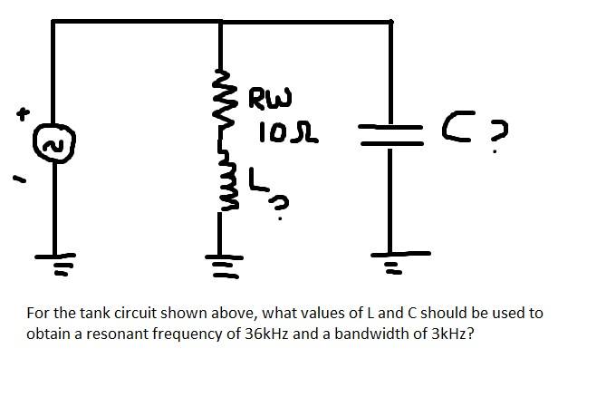

2. Homework Equations
Resonant Frequency = 1 / [2 * pi * squareroot(LC)]
Inductive Reactance = 2 * pi * f *L
Capacitive Reactance = 1 / (2 * pi * f * C)
Q = XL/Rw
BW = fr/Q[/B]
The information in the handy dandy jpeg I created is LITTERALLY all the information I was given for a take home exam. My instructor has never given an analysis problem that couldn't be solved, especially when there are only 2 on the exam. An electrical engineer friend and I couldn't tackle it. Without either the Capacitor, Inductor, or Reactance values I don't know that I have enough given information to solve. If I am wrong, then I lose 20% off my exam.

XL stands for inductive reactance. It is the inductors opposition to current through an inductor. Inductive Reactance equals 2 x pi x frequency x inductance. It is answered in Ohms.
Hi Keenan. http://img96.imageshack.us/img96/5725/red5e5etimes5e5e45e5e25.gif
You start with this equation: BW = fr/Q
determine the unknown, then you move to another of those equations you supplied ...
BTW, I'm not sure what Rw stands for, but I'll pretend it stands for winding resistance

RW is winding resistance.
I cannot believe I didn't see that ...
Q = 12
XL = 120
9K
