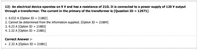

An electrical device operates on 9V and has a resistance of 21 ohm. It is connected to a power supply of 120 V output through a transformer. The current in the primary of the transformer is? (a) 0.032 A, (b) Cannot be determined from the information supplied, (c) 0.23 A, (d) 2.32 A
Primary power = Secondary power
VpIp = VsIs
Okay, so according to the transformer equation, VpIp = VsIs
In this question, I know I have to calculate Ip.
I think given, Vp = 9V, Vs = 120 V
Now I don't know what to use in the value of Is.
Please help!
The answer is 2.32 A.

The more traditional direction for such a power transformer is to call the 120Vrms input the Primary side, and the 9V output the secondary side.
You have the secondary/output power determined by the 9V output and 21 Ohm load resistance. Equating input and output powers (for a first approximation which does not include losses in the transformer) will let you calculate the input current at 120Vrms to generate that power.

That looks very wrong to me. Can you post an image of the problem to be sure that you have transcribed it correctly? Thanks.

Sure sir
Please note sir that these answers are not always correct, as I found many wrong.

@tanaygupta2000, I think this is what the problem is all about. Power balance.
If you follow this procedure, your answer will match one of the options (not d of course ;))
Option - (a)

Secondary power = Vs^2/Rs = 9×9/21 = 3.86W
Primary power = Vp×Ip = 120I
VpIp = VsIs
I = 3.86/120 = 0.032A
