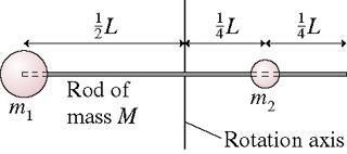

Determine the moment of inertia about the axis of the object shown in the figure. Enter your answer in terms of L, M, m1, and m2.

What have you tried so far?
By the way, this belongs in the homework section.
ok sorry for posting in wrong section.
Ive tried 1/12(m1+m2+M)*L^2 and 1/12(m1+m2+M)*L^2+1/4*m1*L^2-1/16*m2*L^2
The moment of inertia of an object about an axis is just the sum of the moments of inertia of its constituents about that axis; i.e. in this case:
[tex]I=I_{rod}+I_{m1}+I_{m_2}[/tex]
What do you get for these separate moments of inertia?
