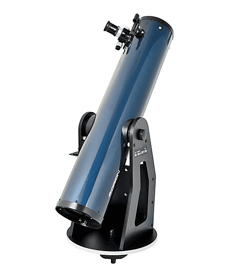

Firstly, let me explain that I am mostly inept at mathematics. Piecing together the required information is becoming a real challenge because of that.
I am motorizing a dobsonian telescope. I have read many accounts of success and the steps involved. The places where detail is commonly left out are: defining worm gear ratio/size and stepper motor oz*in.
I understand the basic problem here, I need to find out force required to rotate the base of the telescope at different distances from it's axis. With the current amount of friction(which will change after a small redesign), I have measured that it requires approximately 2 lbs 15 ounces of force to rotate the base 9 inches from it's axis.
What I really need help with initially is how to extrapolate that data when moving closer to the axis. After that I can begin to calculate gear ratio, stepper motor strength and build my circuits. Some equation where I can input force required and distance from axis.
Any help would be GREATLY appreciated
You have a force of 3 lb acting at a radius of 9 inches . This means you have a torque of 3 lb x 9 inches or 27 lb - inches .
3 lb at 9 inches = 9 lb at 3 inches = 27 lb at 1 inch etc . The product of force and radius is always 27 .
Generally though for most gear and motor calculations only the actual torque is needed .
Post a picture or drawing of your telescope mount if you can .

Photo of a blue Dobsonian reflector telescope on a black altazimuth base, with the tube tilted upward and an eyepiece and finder scope at the top.
Photo of a blue Dobsonian-style reflector telescope on a black altazimuth base, with the tube tilted upward and an eyepiece visible at the upper end.
Thanks for that .
Looks like an interesting project .
Any particular design problems you want to discuss ?
It's an exciting one, that's for sure. I bought a 3D printer and plan on printing my short-term/prototype gears out of nylon. I plan on using Onstep for the actual tracking and GoTo part of the programming. http://goo.gl/eDk5K4
Most of the hard parts are completed already (meaning the software and testing by others). I've fitted the bottom axis with a lazy susan bearing like in the second link I posted. That brought friction down to 5 ounces instead of 3 lbs! Those friction pads work! So if I understand you correctly, that should equal 4.5 lb -inches? Or 72 oz*in?
