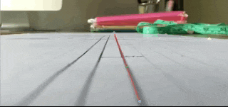

I have a simple paper with parallel grid lines and I know the height of the observer from the ground level.
Now when I snap the picture with my camera, the effect i get is what is seen in the image below. Even if the lines are parallel, the perception is that they converge in the middle.
When i draw lines on the lines of the page, i get angles.
Is it possible that given the information below:
  1. The height of the observer from the ground
  2. The angles generated
That I can calculate the distance from the observer to this "convergance" point? Is there already some formula for this?
The goal is this: If there is some generic formula to calculate the distance from the observer to the convergence point, then I can use this formula in simulation program involving the calculation of small distances.

I'm pretty sure the convergence point is always at infinity, so there's not much to calculate.
Likes FactChecker
Hi thank you for responding. I do not understand. The red lines converge at a point in the gif image above. Which part is infinite?
The distance to where the parallel lines appear to meet (because they never do), as measured on the plane on which they are drawn. Which, as I understand, is what you want to find.
Consider that if it were anywhere closer than infinity, it'd mean that looking farther would make the parallel lines appear to diverge.
The convergence in the gif is the vanishing point - its an illusion of perspective that appears on the plane of the image, and not a point on the physical (ground) plane:
The actual lines stay parallel, and never converge.
By drawing the red lines on the gif, you drew on the image plane, which gave you the vanishing point. If you wanted to draw lines on the ground plane so that they appear to meet in a point, you'd need an infinitely long piece of paper.
This is, by the way, not parallax (what your thread title suggests). With parallax you're not dealing with parallel lines, and the angles you measure are how much they deviate from parallel.
If you actually measure the angles on lines that are not parallel, but meet at a point on the target, then you can do something. But you are actually using lines that never meet. As others have pointed out, if you made the measurements with perfect precision, you would get an infinite distance. So the only way you could get a finite distance as an answer would be if you made a measurement error and the associated distance would be an error.
Suppose you did have two straight lines from a target point to the foreground, one on your left and another on your right at known positions. Camera lenses distort angles. You would have to take that into account and it would be a can of worms.

While I'm not sure if your quest for vanishing point is the right direction to go (e.g., with two pictures you are actually doing parallax) - there are some equations on its wikipedia page.
If you know all the variables in a simulation, then why can't you just directly calculate the distance from the viewpoint to the target? The usual problem in a 3D simulation is trying to get the visual to match the known geometry and distances, not the other way around.
