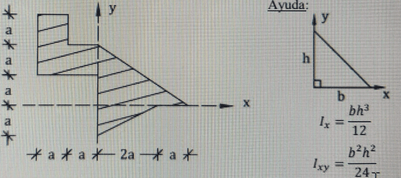

Hello I have problems with this exercise
For the painted area calculate inertias with respect to the x and y axes and the principal inertias
Hint:
$I_x = \displaystyle\frac{bh^3}{12}$
$I_{xy} = \displaystyle\frac{b^2h^2}{24}$
Thanks

Keeping in mind the superposition property of the moment of inertia, can you split this shape up into pieces and evaluate ##I_x## and ##I_y## for them separately?

I am totally blocked

That's also called a moment of inertia!

Ok I'll try

I note you only quote equations for a triangle. Do you have any for the rectangles? If not, you'll need to cut those into triangles.
Do you know the parallel axis theorem?
