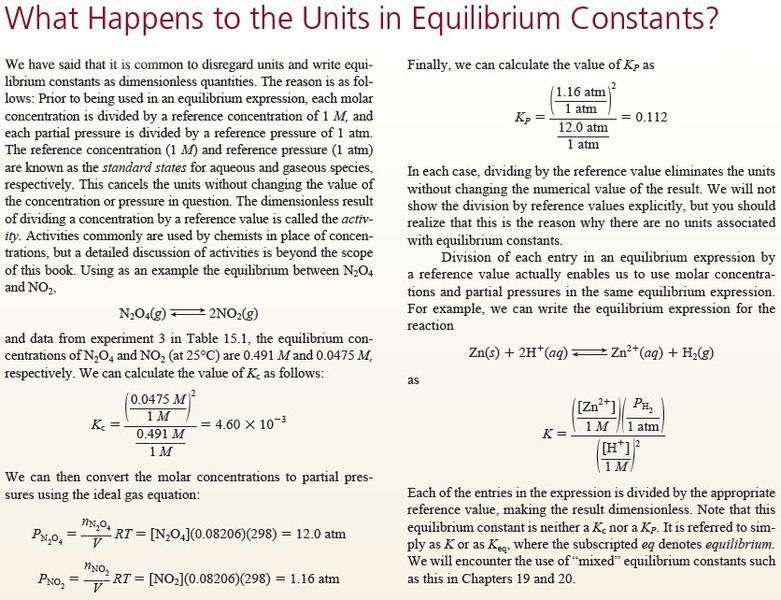

If someone could check my work on this, I'd appreciate it:
Thanks!
Number fits the data given, but is an insult to the logic - 8000M concentration doesn't make sense.
That's what made me question the answer myself. 8000 mol/L sounds ridiculous.
I quadruple checked the work though, and put the 8.8x10^3 value back into the original equilibrium expression, and it does come out to 1.60773043 × 10^(-2) (2 s.f. in that, as well), so I guess that it's correct. *shrug*

Gen chem, so all equilibrium constants are dimensionless. Period.
You're talking about stuff in physical chem. I have enough on my plate without adding unnecessary complexity, thanks.
Here's a more complete explanation, though:
Besides, this problem was about finding the concentration of one of the reactants. The units work out to Molarity^1, which makes perfect sense, so... what's the problem?
To Borek: ok, fine. This is an actual reaction that is used in industry every day, so how about you tell us all what the "real" concentration is supposed to be?

I could not come back earlier, for one thing I could not see your inserts on my device.
Maybe I am out of date then but I remember we always used physical units for equilibrium constants in biochemistry and biophysics as far as I remember. We seem to be finding that a disadvantage of the convention you quote is that we cannot do or check the calculation so I wouldn't agree it has simplified life. Unfortunately I could not find this equilibrium constant in a Wiki search.
You are following the implicit convention of your quoted text K = (product of concs. on right)/(product concs. on left) , then I get the same as your calculation
[CO] = 141.54/K which gives result agreeing with your absurd one.
I wondered if the convention were otherwise and K = 1/1.6*10-2. Then I get a more reasonable sounding 2.26M for the CO.
But still that is about 50 atm. In a flask?. The other concentrations are small fractions of atmospheric. Quite far from a reasonable concentration for an industrial operation and even a laboratory experiment.
All the numbers sound rather screwy, I wonder if anything has been mistranscribed at any stage. Unless your papers are marked by computers you get credit for showing you know when an answer is somehow wrong. I hope you will come back and tell us more if this is class work that is marked or discussed.
