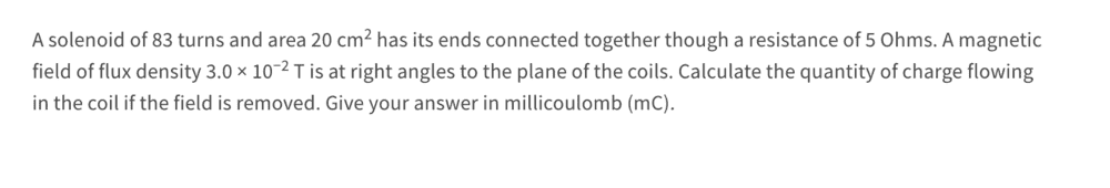

Calculate the charge flowing in the coil if the magnetic field is removed
Faraday's law
Hello
So here is my question

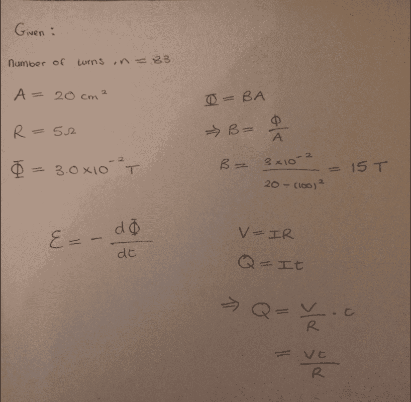

Not so sure how to approach this question
This is what I have worked out so far which is the magnetic field strength of the solenoid, not sure if this comes in helpful though

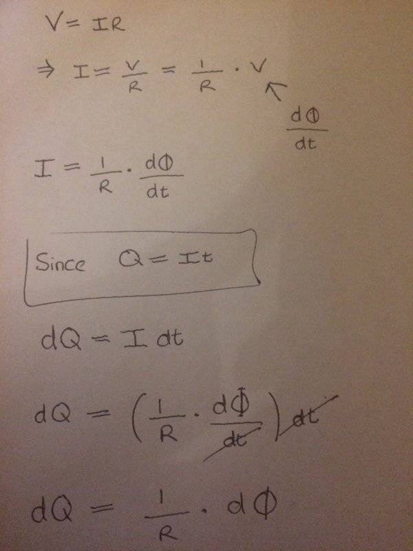

Ignoring the negative sign, start with ##I=\dfrac{1}{R}\dfrac{d\Phi}{dt}##.
Then integrate ##dQ=Idt##.

I'm not so sure about the integrate part
I know that charge Q is I*t, and I used that expression of I that was used before to sub into the integration step giving me this

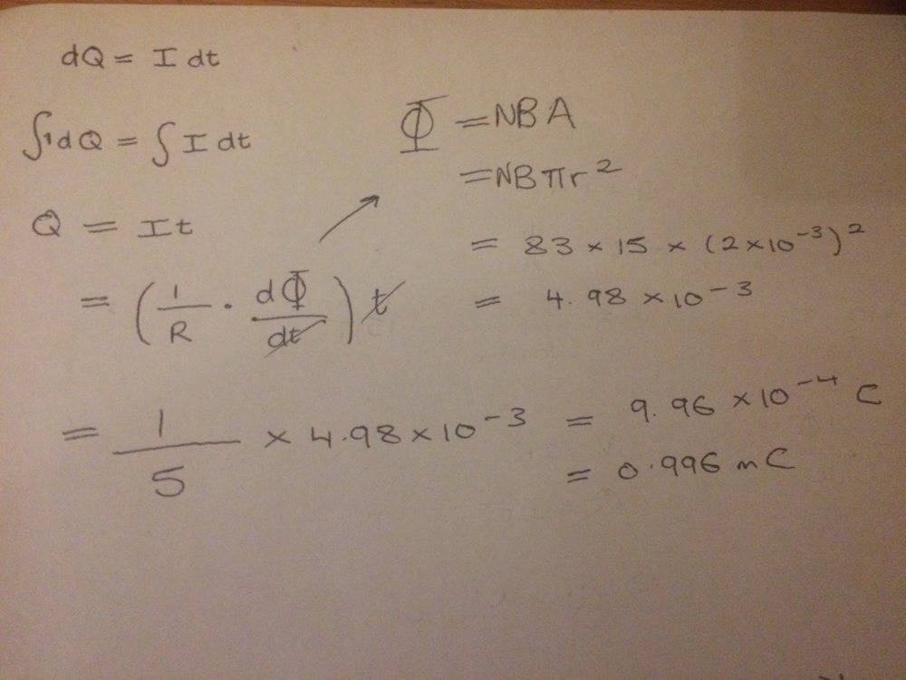

Be sure. Just write it out and see what you get. Q=I*t only if I is constant in time.

Ok this is most likely wrong :( but I got this when I write it out
I know previously that the magnetic field strength is 15 T from using magnetic flux linkage = BA earlier on

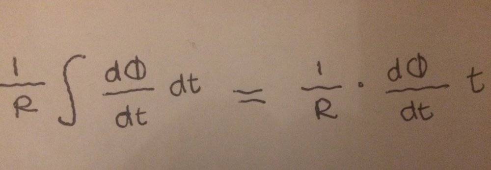

Yes, you did it wrong. You should know better than to cancel ##t## in the numerator with ##dt## in the denominator. At least you didn't cancel only the ##t##'s and leave the ##d## in the denominator. :oldsmile:.
You didn't do what I asked you to do, namely write out the integral.$$\int dQ=\int Idt=\frac{1}{R}\int\frac{d\Phi}{dt}dt=?$$You know the left hand side integrates to the total charge ##Q##. What does the right hand side integrate to and why?
So right hand side integrates to this?
But we aren't given a value of time in the question so how can this help us?
You can cancel the two dt's here:
Also, note that the magnetic field B is given to be .03 T, it is not 15 T.
Φ is "flux", B is "flux density".

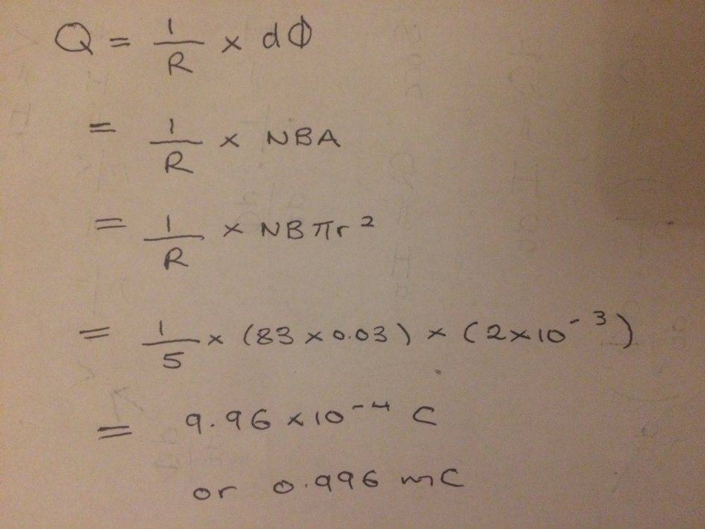

So if the two dt's cancel each other out.
That should mean that the total charge flowing is 1/R * (change of flux)?

I get 0.996 millicoulombs to be my answer?
OK. The data is given to 2 significant figures (except for R). What is your answer to 2 significant figures?

It would be 1.00 mC to 2 sig figs
That's 3 significant figures :oldsmile:
Ok so 1.0 mC :doh:, I thought you had to discount the first zero to begin with in 0.996, my mistake
