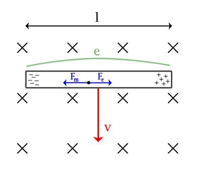

Imagine that there is a wire connecting the two magnetic poles, (+,-) so there is an induced current and not only an ems.
Hello there!
I'm wondering if I can use both of these methods to calculate the direction of the current.
The first one is Lenz Law. If I've understood the law currently, it helps me to determine the direction of the current, by knowing that the direction of the ''force'' that builds up is opposite the direction of the already there force, and therefore I can just use the right-hand rule and determine the direction of the current. So in this case( see image below), the force is pulling the object down, Lenz Law states that an opposite force should go upwards to prevent the movement of the object from going downwards, then I get that the direction of the force should go upwards, and give me that the current should go to the right.
However, this method is something I learned after my first one, which I've always thought should be used..
BUT! Can I also use this method?:
If I assume that the electrons are going in the same direction as the velocity I'm pulling the object downwards with, then the current should go UP, while the electrons move down. If I use the right-hand rule on this, I get that the Fm(Magnetic Force) should go to the left, this tells me that the right-end is the positive pole and the left-end is the negative pole.
Then I know that the current is flowing from + to - and from that method determine the direction. Is this possible?
But! In the first method, when I used Lenz Law, I got that the magnetic force is going UPWARDS. However, in my second method, I got that the magnetic force is going to THE LEFT just like in the image.
Are these two different forces or what?

The two rules you are talking about describe different effects.
Lenses Law applies when the movement results in a change in flux density at the conductor.
In your example, the magnetic flux stays the same.

Weird, that's not mentioned anywhere in my book and it has not been used in the examples either.
So Lenz Law should only be applied when the magnetic flux changes?
But can I still use "my method" even if the flux changes?

I think you should go back over the examples carefully - is Lenzes law ever used in a situation where the magnetic flux does not change yet there is a net opposing force?
Lenzes law and Faradays law:
http://hyperphysics.phy-astr.gsu.edu/hbase/electric/farlaw.html
You can use it where the flux does not change - but that means: ##\Delta (BA)/\Delta T = 0##
So the force is zero. (see the link)
You'll notice that hyperphysics uses coils for their examples - your book should too.
You may have seen examples involving flat sheets of metal that could contribute to the confusion.
The rule you have seems to be from:
$$m\vec a =q(\vec v\times \vec B)$$ ... v is the velocity of the charge.
It does work if the flux changes - you just have to be more careful when you use it.

I see, I see.
The issue is that the magnetic flux does infact change if I think about it, however it's nowhere mentioned that that it has anything to do with magnetic flux nor that the flux actually changes in the examples provided in my book. It just states that Lenz Law is that a force is ''created'' in the opposite direction of the existing one, in order to prevent the motion and thus we can obtain the direction of the current from that.
That's pretty much everything that Lenz Law states in my book. It's a book written in swedish.
But thank you once again, I'll perhaps just stick to using the other rule for now to determine the direction of the current.
Best regards & Thank you a lot for your help.
Oh yeah - technically Lenzes law is about the direction - Faraday's law states that the flux has to change.
In examples you should see that though ... do they have any examples for lenzes law where the flux does not change? Or maybe this is one of those conceptual physics courses?
Really? No pictures or examples? Sounds like a textbook to be avoided.
Note: if the example involves moving towards or away from one pole of a bar magnet or an electromagnet, then the flux changes. They don't have to say - you are expected to understand that from the circumstances.
The magnetic force law is not going to help you with coils much though. Say, instead of a bar, the moving conductor was a loop? What's the current?
