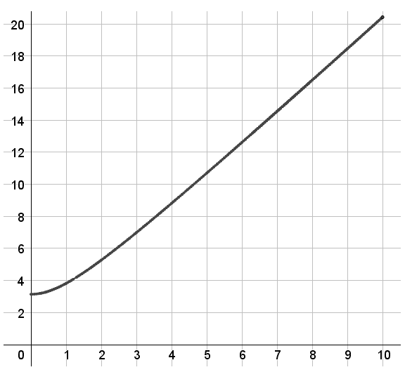

The period depends on ##k##, should be pretty straightforward to figure out the ##k##-dependence for the curve lenght.
Here is a plot I made for curve length with dependence of the amplitude ##A## keeping ##k=1##.

Hi malawi_glenn. Thank you for your answer. However, what is the exact mathematical expression for the result? From your graph: if the amplitude is zero then the arc length is 3.2?
Something with Elliptical functions ;)
Why should it be 3.2?
