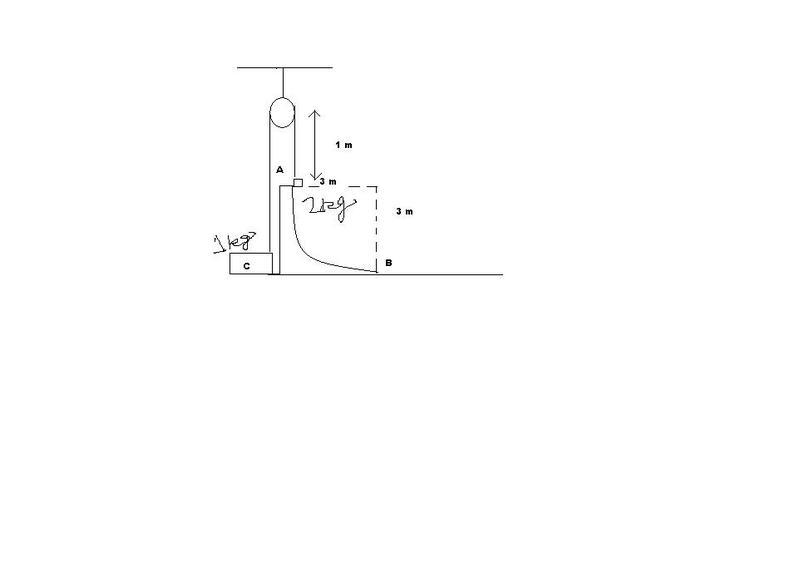

Consider the following arrangement
Calculate the work done by tension on 2kg block during its motion on circular track from point A to point B.
We know that work done by a force is product of force and displacement.
We know the displacement of point of application as 4 m. How to find the work done by the tension as it is not constant it is variable.

Conservation of work will do the integration for you. Think about the changes in potential and kinetic energy of the two blocks. (Don't assume the system will be at rest when point B is reached.)
how?
You need a couple of steps to solve the problem
1 Consider the two blocks and the string together as the system.Apply work energy theorem.Work done by tension will cancel out.This will give you the kinetic energy of the 2 kg block when it reaches point B.
2 Now,consider the 2 kg block in isolation.Again apply work energy theorem.This time the work done by tension will be equal to the change in the mechanical energy of the 2 kg block .Note that the work of the normal force by the circular track on the 2 kg block will be zero.

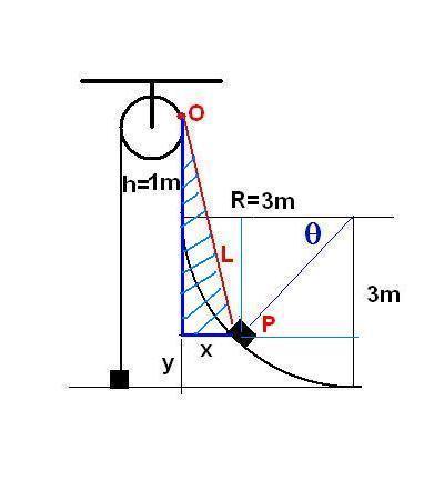

The 2 kg block moves along the circle, so its speed is Rdθ/dt. It pulls the string, the length of the string between point O and the block can we obtained with simple geometry at any position θ (ignoring the size of the pulley). The total length of the string is unchanged, so the speed of the 1kg block is dL/dt.

After that what to do?
After what? Have you the expression of dL/dt in terms of theta?
ehild
YES ,dL/dt=Rdθ/dt.BUT THAT'S SAME AS V=RW HERE W DENOTES ANGULAR VELOCITY.

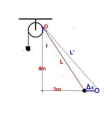

No. At B, the 2kg block is traveling horizontally. The string is, presumably, still taut, so makes a straight line diagonally up to the pulley. The speed of the 2kg block will not be the same as the speed of the string over the pulley.

Try to figure it out. First find the length of string between the 2kg block and point O. Then take the derivative with respect to time.
ehild
first the length is 1m then 4m.
please help...
No. The block does not travel vertically. It goes also sideway. And what is in between?
ehild
i wanted to say that the change in length is 4 m.After that?
Well, the length of the right piece changes by 4 m. But what is between the initial and final position?

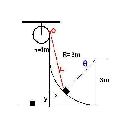

Find L at a given theta.

Is that necessary? I think what's needed is to find the length of the string as a function of the 2kg's distance along the baseline from, say, point B, once it is moving horizontally. (Then differentiate that and evaluate at B.)
dl/dt = 6cos(theta) +18sin(theta)..is it correct
You are right. The final speed is only needed, and it can be obtained using the horizontal speed at the moment when the 2 kg mass reaches the floor.
