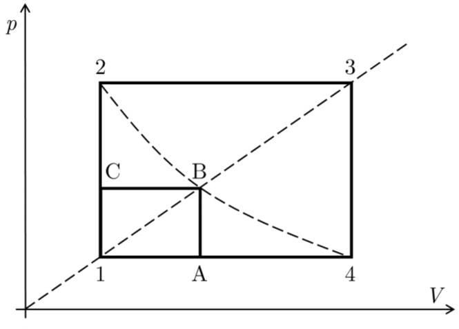

Calculate the temperatures at places 2, 4, A, B and C if you know:
It's an ideal diatomic gas
T3 = 4T1
T2 = Tb = T4
The axis connecting 1, B and 3 crosses zero.
pV = nRT
Laws of thermodynamics
I only know T3 = 4•T1
I was able to calculate the T2 = Tb = T4
I built four equations:
T2 = p2V1 / nR
T4 = p1V2 / nR
p1/T1 = p2/T2
V1/T2 = V2/4T1
I put them together and got T2 = 2T1
I can't figure out the temperatures of A and C. I tend to think Ta could equal Tc (then I would be able to calculate it), but I am not sure.

Are you sure you have rendered the complete problem statement ? I would expect some more information, like: ideal gas, isothermal (or adiabatic), ...
I also miss an equation of state in your relevant equations (e.g. ##\ pV = NRT##).
Seeit said:
I only know ##T_3 = 4T_1##
How ? Or was that a given ? (In that case it is part of the problem statement)
Same for ##T_2 = T_b = T_4## ?
What about the scale and the axes of the diagram ?

As post #1 has been edited to answer @BvU questions, I suggest considering two things:
-The inverse proportionality between p and V.
-The similarity between polygons 1CBA and 1234 due to the axis connecting 1, B and 3, which makes their corresponding sides proportional.

So am I right about thinking that A and C are on the same isotherm and have therefore the same temperature?
Correct!
