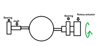

Hi,
I've got a cylinder which needs to turn 90 deg. clockwise and 90 deg. counterclockwise (seen below from the front and above). How do I calculate the necessary torque on the engine? I can disregard the weight of the bracket holding the cylinder. Any help would be much appriciated!

How about you at least list the things that you think you might need to know in order to make such a calculation. For example, does the weight matter? Does it matter how fast you want to turn it? Etc ...
Are you in a hurry with this turning, or can it take a few days ? Makes a difference !
Are you aware of the relevant equations ? And the similarity of the equations for rotation with the equations for linear motion (the SUVAT eqns)
This link shows moments of inertia
This homework or work at home ?

Thanks for your replies and links. I have only tried to calculate bending moment. I have no idea how to calculate torque so I am not familiar with the equations. I expect I will need to know the weight of the cylinder, the speed as you mention and maybe moment of inertia of the cylinder.
"This homework or work at home ?" Not sure what you mean?
I guess I need the weight * g * distance to center of shaft. But not sure where to place the forces if that makes sense.

If you say 'cylinder', we assume a massive cylinder. Or do you mean a hollow cylinder with a bottom (a tin can so to say)? makes a difference !
Again PH was faster :woot: and you already replied. Homework: Post in homework and state the FULL problem and relevant equations. You are also required to post your own effort at solution !
It's a massive cylinder.

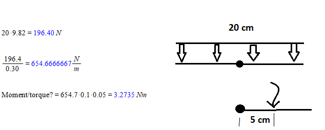

Sure thing, I realize I asked a too, ah, open question. Well here is my attempt:
Weight of cylinder: 20 kg (evenly distributed load)
Lenght of cylinder: 30 cm

You mentioned 90 deg clockwise and 90 deg anti-clockwise. With 15 rpm you mean that such a turn should be completed in 1/60 of a second ?
I find that the questions in #3 and #7 haven't got an answer yet.
And I'm prepared to believe 20 * 9.82 = 196, also that 20 kg * 9.82 m/s2= 196 N, but 20 * 9.82 is not 196 N. I don't see what you are calculating with that: what's the 0.1 and what's the 5 cm ?

Sorry, I shouldn't have been stingy with the units:
Handwritten-style worked calculation: 20 kg times 9.82 m/s² equals 196.40 N; 196.4 N divided by 0.3 m equals 654.67 N/m; torque 654.67 N/m times 0.1 m times 0.05 m equals 3.27 Nm.
The 0,1 is just half the length of the cylinder and the 0,05 half the length of that. The black spot is where the shaft is attached. Sorry I'm not doing a very good job explaining what I'm doing, english is not my first language.
I guess my question is if the above is in any way a way to calculate the torque disregarding friction?

First decide on an angular velocity profile for the desired motion. From that you can find the angular acceleration profile. Torque will depend upon the angular acceleration. If the cylinder is starting from rest at one position, it'll have to accelerate up to some angular velocity and then decelerate back to zero. You haven't mentioned anything about how you will detect when the required position has been reached. Is there a feedback loop of some kind for motion control?
RanTanPlan said:
don't understand how 15 rpm becomes 1/60 of a second? I figured it would be 1 sec to make a quarter-turn at 15 rpm?
My bad o:), sorry. 1 second is a lot better. In that one second, it has to accelerate from standstill, and decelerate to standstill again,as @gneill writes, I suppose? Can you do the calculations for a linear motion, with force instead of torque and mass instead of moment of inertia ?
Nope. You need moment of inertia - as provided in link in #3
