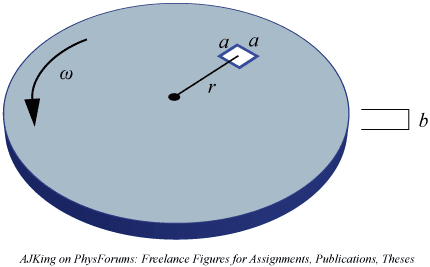

Refer to Figure attached.
A disk of conductivity σ and thickness b rotates around an axis through its center with a magnetic field B applied perpendicular to the plane of the disk over a small area a2. Find the approximate torque tending to slow the disk at the instant its angular velocity is ω.
[itex]\xi = -B \frac{dA}{dt}[/itex]
[itex]= -B a \frac{da}{dt}[/itex]
(Right here ^ Can I do this?)
[itex]= -B a v[/itex]
[itex]= -B a \omega dr[/itex]
[itex]\Rightarrow \int^{r+a/2}_{r-a/2} -B a \omega dr[/itex]
[itex]= - B a^2 \omega[/itex]
And
[itex]R = \frac{L}{\sigma A} = \frac{a}{\sigma ab} = \frac{1}{\sigma b}[/itex]
Thus
[itex]F = i a \times B[/itex]
[itex]= \frac{\xi}{R} a \times B[/itex]
[itex]F = - B^2 a^2 \omega \sigma b[/itex]
[itex]\tau = \int F dr[/itex]
[itex]\tau = - B^2 a^2 \omega \sigma b \int^{r+a/2}_{r-a/2} dr[/itex]
[itex]\tau = - B^2 a^3 \omega \sigma b[/itex]
I think I've handled my integrals poorly...
will revise.
