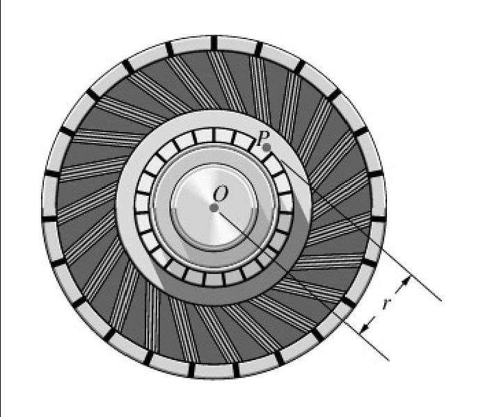

Point P rotates around the center O at a constant rate.The magnitude of the velocity of point P relative to O is 3.7 m/s and the distance between the two points is 90 mm. What are the magnitudes of (a) normal and (b) tangential components of the acceleration of P relative to O?
an = v2/r
So I was able to find the normal component of acceleration using the formula an = v2/r and got value of 152.11 m/s/s. But for tangential component, I'm confused, the point doesn't actually accelerate (it travels at a constant speed). So does that mean that at would equal to zero? Or am I misunderstanding something here?
Thank you!
I think you are right, the tangential acceleration of point P must be [tex]\frac{0m}{s^2}[/tex] otherwise it's SPEED (and not velocity as written) wouldn't be a constant with respect to point 0.
Sweet, thanks!
