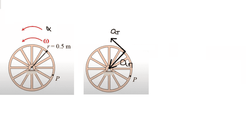

On picture
##\theta = \theta_0 + \omega _0 t + \frac {1}{2} \alpha t^2##
##\omega = \omega_0 + \alpha t##
##\omega^2 = \omega_0^2 + 2 \alpha (\theta - \theta_0)##
##a_t = \alpha * r##
##a_n = \omega^2 * r##

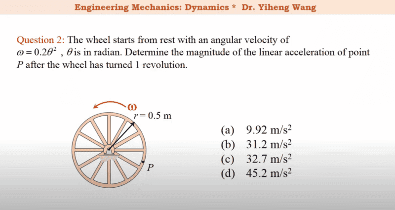

Answer should be (c) 32,7 ##\frac{m}{s^2}##
My attempt:
##\omega_{2\pi}## -> ##\omega## after 1 revolution
##\omega_{2\pi} = 0,2 * (2\pi)^2##
##\omega_{2\pi} = 7,9 \frac{rad}{s}##
##\frac {d}{dt}\omega = \alpha = 0,2*2*\theta##
##\alpha_{2\pi}## -> ##\alpha## after 1 revolution
##\alpha_{2\pi} = 2,51 \frac {rad}{s}##
##a_n## -> normal acceleration
##a_t## -> tangential acceleration
##a_t = \alpha_{2\pi} * r = 1,26 \frac {m}{s^2}##
##a_n = \omega^2 * r = 32,205 \frac {m}{s^2}##
##a = \sqrt{a_n^2 + a_t^2} = 31,2 \frac{m}{s^2}##
Does ##\alpha## have the proper units of angular acceleration in your derivation?
I am concerned with:
You are given ##\omega## as a function of ##\theta##. But you appear to have differentiated with respect to ##\theta## and obtained a derivative with respect to ##t##.
No ##\alpha## have unit ##\frac{rad}{s^2}##
But that does not change anything.
That is my mistake.
Thanks.
It should be:
##\alpha = 0,2*2*\theta*\omega##
Derivative of ##\theta## with respect to time is ##\omega##
But it does.
For future reference: If you derive something, and its units do not match the quantity you are after then there is a mistake in said derivation.
To summarize, $$\alpha=\frac{d\omega}{dt}=\frac{d\omega}{d\theta}\frac{d\theta}{dt}=\omega \frac{d\omega}{d\theta}.$$What is the tangential component ##a_t##?
##\alpha## is angular acceleration.
The term “linear” acceleration is confusing in the problem statement. What I think is being calculated is just the magnitude of the acceleration?
Yes
In addition to the other comments, can I add that the hypotenuse is the longest side of a right-triangle.
