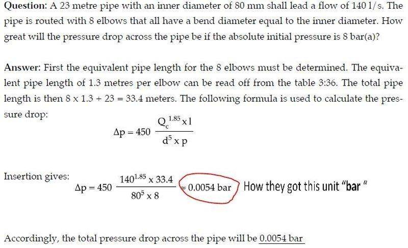

I am in a study of sizing air compressor for a new manufacturing plant ,I googled for some calculation and i got the problem shown in the attachment .i have one doubt how they got the unit bar in the final answer ...?
  • Worked pipe pressure drop example: 450 times 140 to the 1.85 times 33.4 over 80 to the 5 times 8 gives 0.0054 bar, with the bar unit circled in red.
That's the kind of equation that only works with a given set of units. The book must mention somewhere what these units are (like ##l## must be in meters).
What is not defined is the units for the "450" constant value in the equation. Many times this type of constant includes in its value some type of units conversion ratio.
