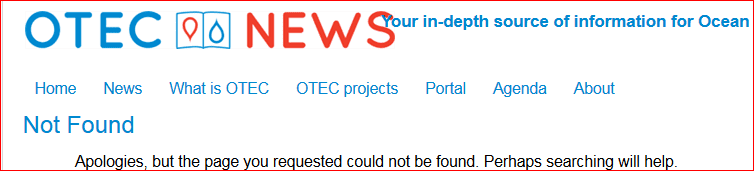

I want something similar to used in open cycle OTEC experiments like http://www.otecnews.org/articles/vega/07_landbased_OTEC.html . Kindly look at the compressor system fitted to the Condenser of this experiment.
returns
Hmm not a lot to go on there
