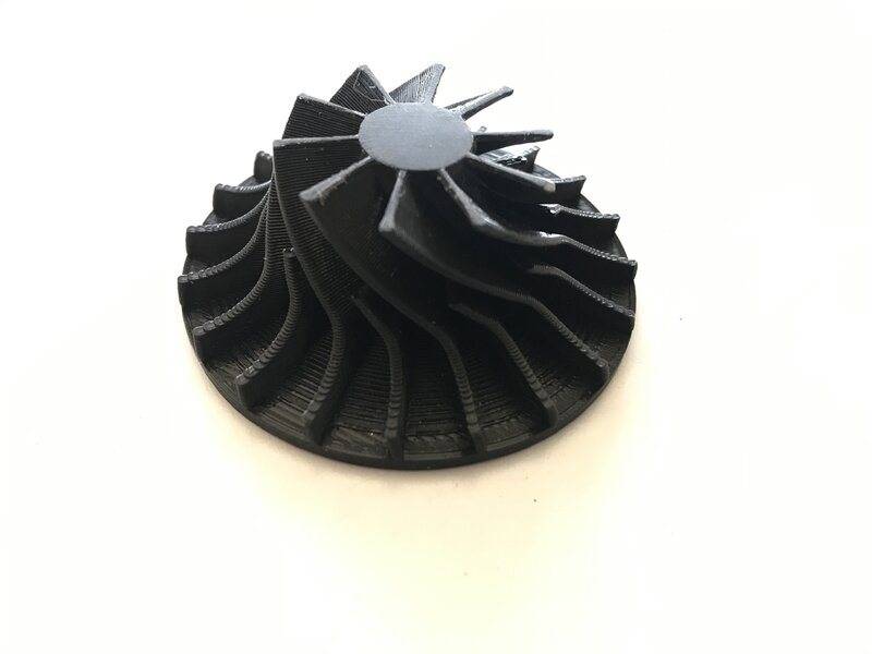

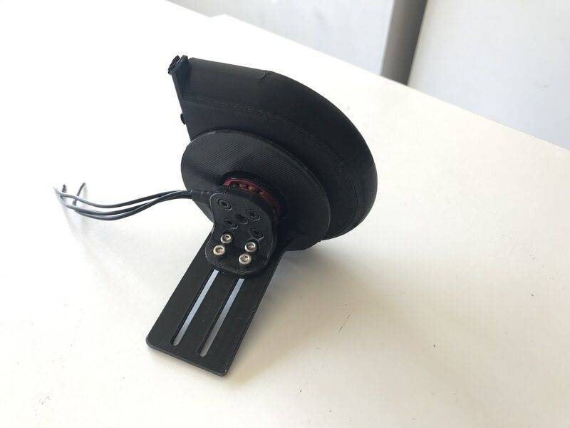

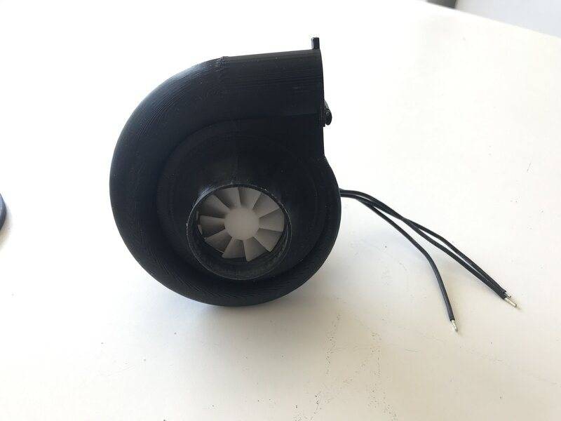

Hello everyone,
Nowadays I am planning to redesign my centrifugal compressor which I designed for a subsystem in my graduation project. It's a 3D printed and brushless motor driven centrifugal compressor and its about a hand size. However, due to its relatively small size and relatively low RPM ( about 15,000 RPM) it didn't provide enough pressure. In fact, I knew that it won't work because I designed it to reach 1.01 bar :) because I was limited by the material, motor and the budget. I just wanted to give it a try.
Anyway, now I want to scale it in order to reach about a 2 bar. Without doing any changes on the blade profile or casing (maybe I do because there may be choking) I will increase the motor speed with a gearbox and also scale up the model to increase the tangential velocity of the blade tip.

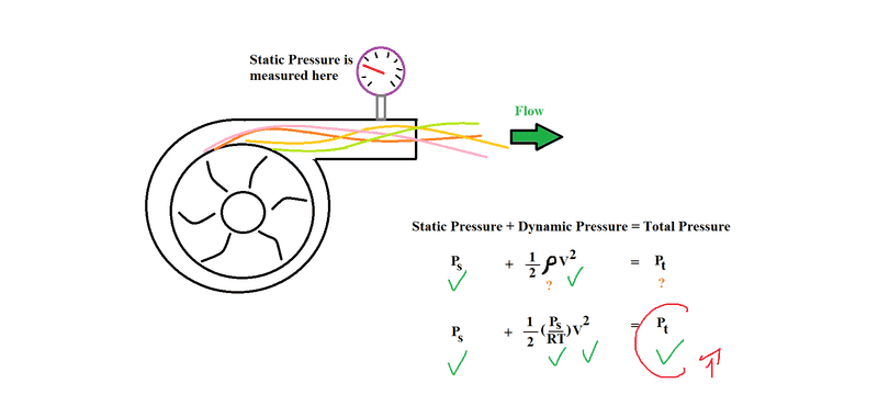

This time, I want to measure the values in order to validate my calculations. Therefore, I need to know total pressure of the blowed air. I am going to buy an absolute pressure manometer for gases and place it to the end of the compressor. This will measure the static pressure of the air.
I will approximate the air velocity from the tangential velocity of the blade (because I will be able to measure motor speed with a tachometer).
But since the density in the dynamic pressure is coupled with the pressure and temperature. I am planning to calculate density from ideal gas law. Assuming the temperature increase is not significant, taking the room temperature and static pressure measured in the compressor the density and eventually total pressure can be calculated.
So my question is that is this process correct? Would I get reasonable values? Here, the total pressure will be a function of the static pressure measured and temperature (approximated).
Thank you in advance,
Measuring the output of a centrifugal compressor requires a little more sophistication. First, you need to measure the entire fan curve, not just one point. That requires an adjustable restriction on the downstream side. Good search terms to learn more are fan curve and measure fan curve. An example of a set of fan curves for a large industrial blower at various speeds:

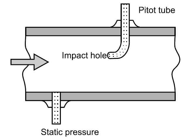

I suggest adding a diffuser to the output so that you need only measure the static pressure. If you really want to measure both static and dynamic pressure, you need a pitot tube (search the term). A simplified sketch of a pitot tube is shown below:

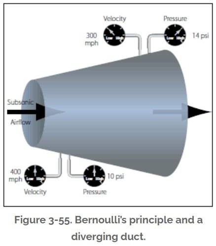

A diffuser is a tapered increase in duct diameter for the purpose of slowing down subsonic flow, thus increasing the pressure. An example is shown below:
If your compression ratio is 2.0, (1 bar to 2 bar), then the temperature increase will be significant.
