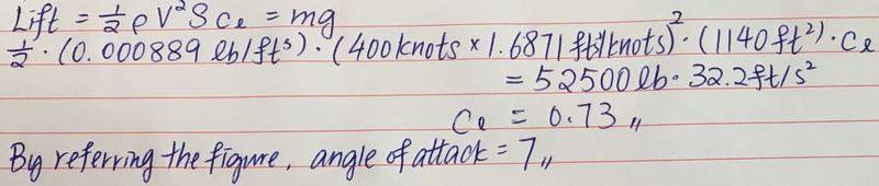

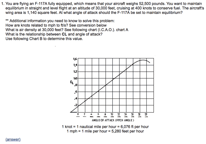

1. Homework Statement
https://i.imgur.com/tG9unNs.png
2. Homework Equations
in picture below
3. The Attempt at a Solution
https://i.imgur.com/egZC3Ay.jpg
I calculated the angle of attack is "7", yet the answer is "1", which implies the coefficient of lift is about 0.2 from the answer. I am not sure where of my answer have got mistake...
can anyone help?
thank you very much!

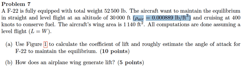

I think there is a problem of slugs versus lbs. Standard atmosphere has density 0.000889378 slugs/cubic foot, not lbs/cubic foot. Using your numbers, I get Cl = 7.3, which is way too high. But dividing by 32.2 gives Cl = 0.23
Thank you very much!
It is because https://i.imgur.com/a43giFt.png is what I have got in my assignment and I misunderstood lb(f) as lb(m) represented by lb in the question.
So, I do not need to multiply 32.2 on the right side.
Thank you so much for reminding me!
