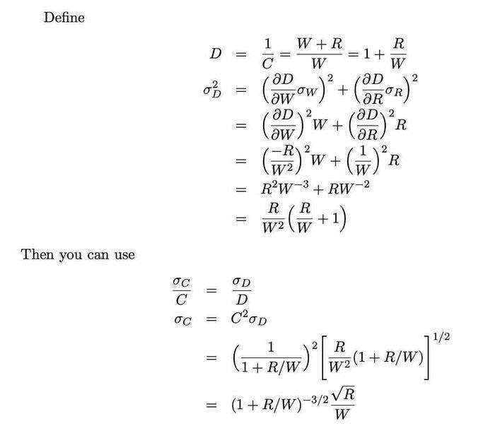

Hi all,
I'm having a bit hard time performing error calculations on one of the lab results I got.
The lab dealt with finding collection rate of a certain material onto a wire. While inside a vial, the wire was soaked in the material for a specific period of time. Then the wire was taken out of the vial and both the wire and the vial with the remaining contents were measured.
Note that it is given that the collection rate is governed by Poisson distribution.
The collection rate is simply given by: CR=W/(W+R)
where: CR = collection rate; W = measuring the material content which stuck on the wire; R = measuring the material left in the residue in the vial
I have an excel sheet with a couple of such measurements, and now I would like to calculate the relative error in this experiment.
From what I know, I'm dealing with a reciprocal error calculation:
(*) Error = sqrt((1/W+R)^2*sW^2) + (-W/R^2)^2*s(W+R)^2)
My questions are:
1. Does sW and s(W+R) simply equal to sqrt(W) and sqrt(W+R), respectively?
2. Since one of the parameters is a sum of 2 values - W+R, should I calculate its error by using sum-error formula: sqrt(sW^2+sR^2) rather than treating this number as a united parameter as I wrote on point 1.? But what should I plug instead of sR? I feel like I'm stuck in a recursive loop.
Also, would it require me to modify the overall error formula I used (*) in any way?
Thanks!

Care is needed here in several respects
1) For Poisson Statsistics to be used it is indeed important that W and R are not rates, but counts in the same interval of time. In that case the standard errors on W and on R+W are indeed Sqrt(R) and Sqrt(R+W) ie the sqrt of the counts in each case
You could equally get to s(R+W) by saying it is Sqrt (s(R)^2 + s(W)^2) = Sqrt ( R + W)
2) The formula for combining errors as the sqrt of sum of squares assumes that the errors are independent. The errors on R and on R+W are not independent. You need to work through the effect on CR of an error in R and and of an error on W and then combine THOSE as the sqrt of the sum of the errors
Yes, the quantities W and R are correlated. The propagation of errors formula includes a cross term and needs inclusion and consideration in your error formula. Using your notation this term is
+2·(sWR)2·(∂CR/∂W)·(∂CR/∂R)
With sWR being the covariance of W and R.

I think Gleem's formula is correct, but its messy to expand. Its easier to consider the inverse ratio D = 1/CR = (W+R)/W = 1+(R/W) and then use s(CR)/R = s(D)/D.
gleem said:
Let W+R = X so CR =W/X
Error CR = Sqrt[ s(W)2·(∂CR/∂W)2+s(X)2·(∂CR/∂X)2+2·s(W)·s(X)·(∂CR/∂W)·(∂CR/∂X)]There is only one measurement.
just so I make sure I didn't get lost...:
s(W) = sqrt(W)
s(W)2 = W
Correct?
1) I agree with the various comments about systematic errors
2) I am a bit worried about the statement "CPM is being measured" If "CPM" is Counts per minute then you can't use
Error= SQRT(value)
unless the measure is over exactly 1 minute. Fir thius tio be valid "value" must be a count, not a count rate.
Strictly there is another caveat - value must not be too small, because strictly it should be SQRT(true value). If you only get 1 or 2 counts, or even none, the true expectation value is pretty uncertain.
3) Following up my comment
Here is the full calculation ( forgive my change of nomenclature, but I think its clearer)
If you use rate then you can use this.
S..d of rate = ± n1/2/t where n is the number of counts in the counting period t.

Thank you so much! Everything is well explained :)
Can you just please explain why
sigmaC/C = sigmaD/D?
